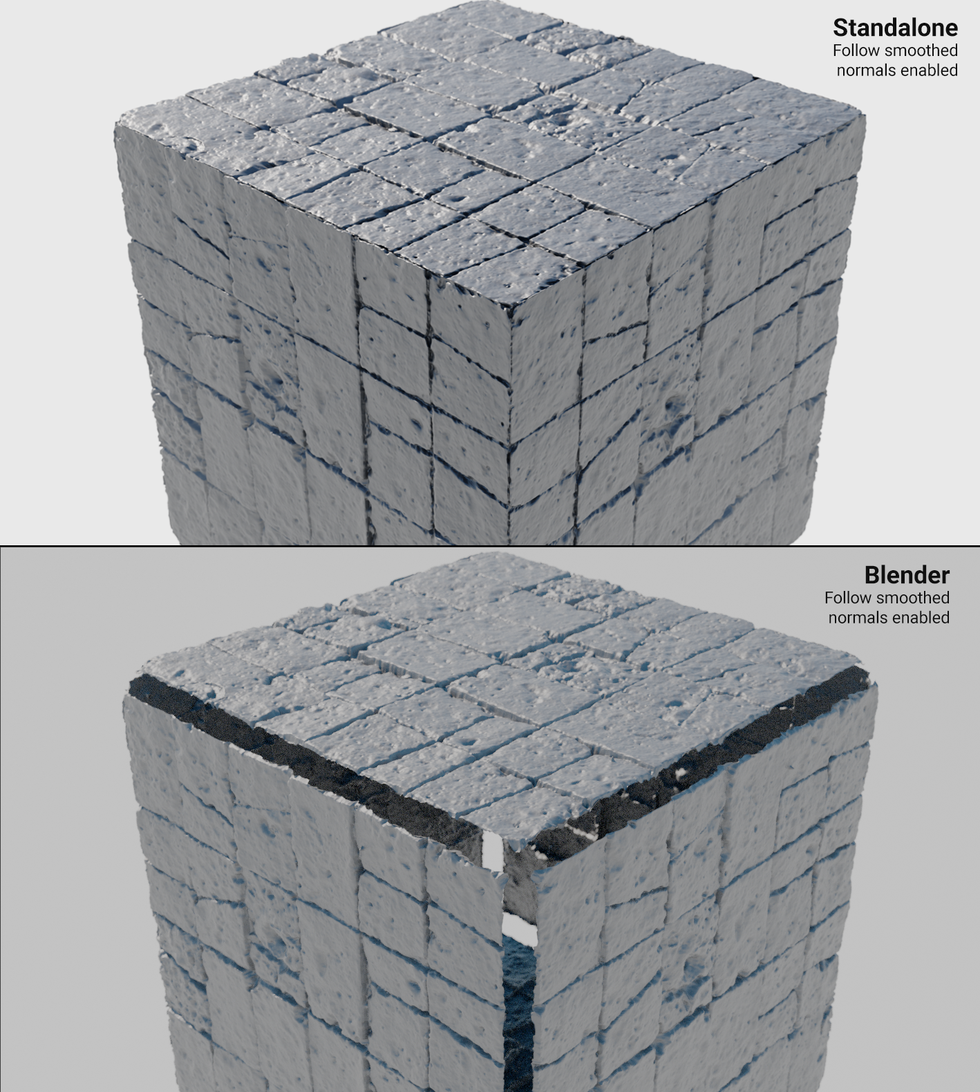

The Displacement direction in Displacement Texture node has no effect in 28.9 and probably in other recent builds too.

Looks like it is an issue when normals of the mesh are set to Shade Flat. When normals are set to Auto Smooth it works ok.
