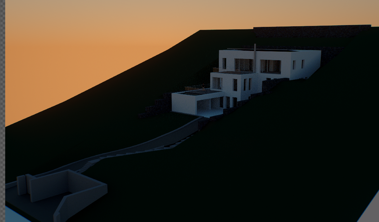

I need to do a light-simulation for a client. It needs to be accurate. But it seems the light stuff is totally off when it comes to times of sunsets.
For example, I took the longest day in summer for my country, which is Germany. It's the 20th of June. Sun will set at 21:00. So if I put in Long/Lat, GMT offset to 1 its already very dark. But sun should shine fully.
With Nishita daylight model, the sky is even darker.
You can test with your own location. Is there a way I can do a proper light simulation? Attached image shows standard Octane Daylight Model.
