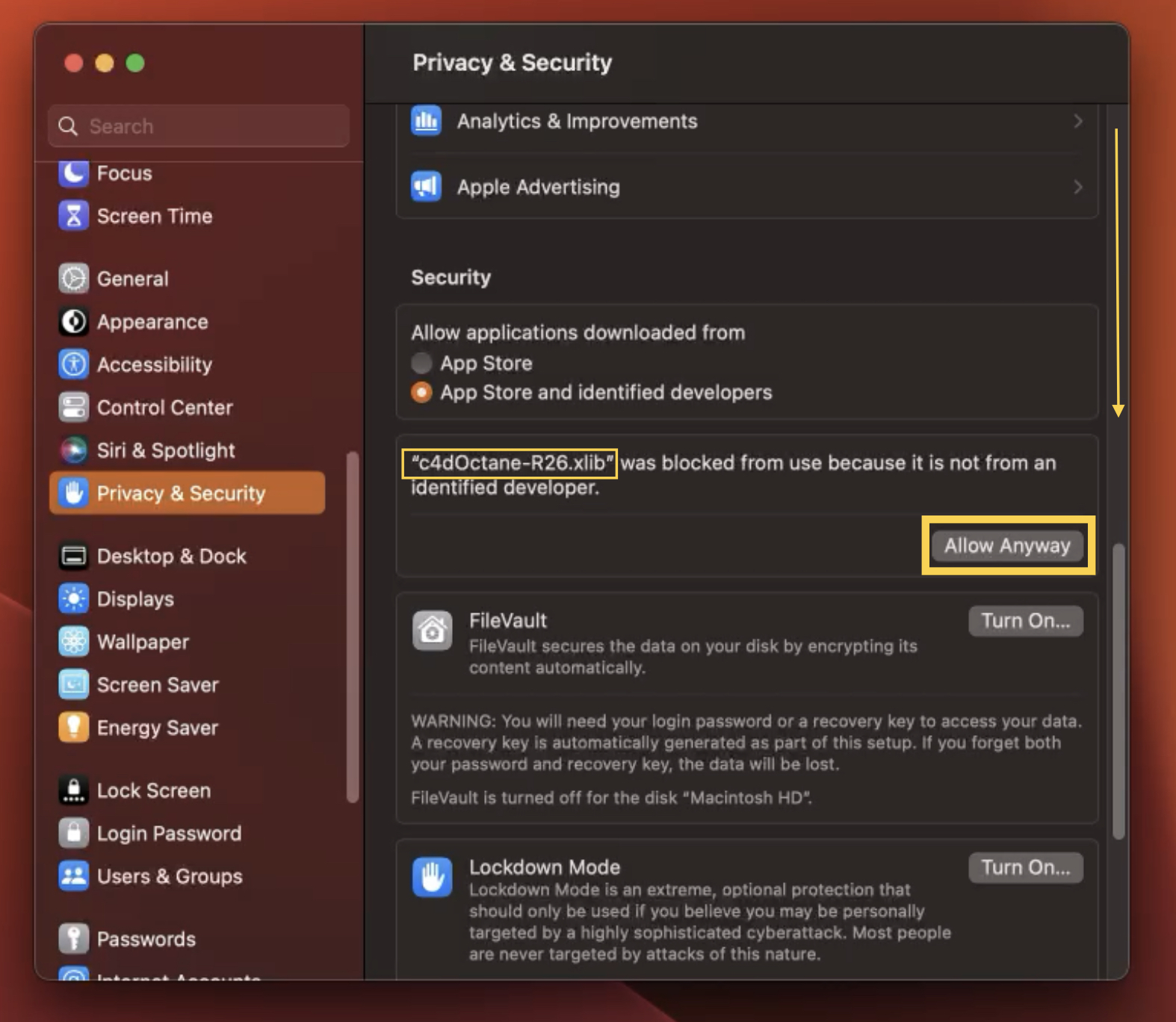

Note that you always need to remove from the c4doctane folder, all the unnecessary c4doctane-R2X.xdlib files not related with R2X specific version, and leave only one c4doctane-R2X.xdlib file in ../plugins/c4doctane directory.
You also need to allow the c4doctane plugin and library in System Preferences/Security and Privacy panel, and restart C4D a couple of times:
