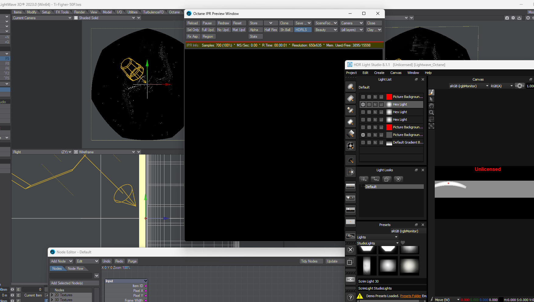

Lightmap Studio doesnt seem to work with Octane in version 2020 or 2023. It works great with 2019 but I just see black when I press the button for HDRLS in the Octane IPR window, has anyone else had this issue?

Hello,
I asked the team from HDR Studio and they told me that
there's an issue with the 2020 plugin, the HDR link is broken,
and wasn't fixed on the last build.
We have to wait for new developments and bug fixes of
the Lightwave plugin...

Octane is included with Lightwave 2023 now. Are Lightwave Digital doing updates ? I've spoken to Lightmap Studio and it needs to be updated in the plugin. I emailed Lightwave digital but got no replay which is a bit poor.

Yep it's broken since LW 2020 BUT only with LW+Octane, LWnative+HDRLS works in LW 2020/2023.
So yes somethgin in LW octane plugin would need to be changed to make HDRLStudio work again with octane plugin.
