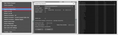

It seems that the window from the manual does not look like the one I find in max.
Either it's an old version or I am not in the right place.
Please see in the screenshot my findings - The steps are from left to right as in 1-2-3.

Hi seesharpstudio,
Render setup > tools

Ohhh. I see - So I was in the wrong place - mistaken only max proxy for the orbx one.
Now it's very clear.
