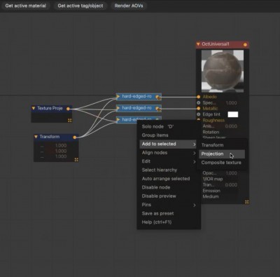

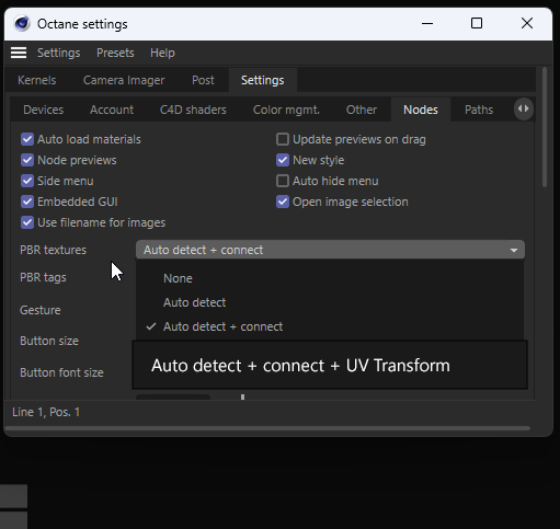

I was wondering if it would be possible to add one more option in the settings to have the maps automatically connected to both UV and Transform nodes.
This would speed things up even more. What do you think?

Hi Peter,
good request, but please consider that you can add both Transform or Projection with one click:

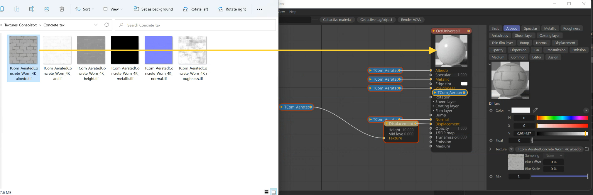

Posts: 10619
Ok, just finished to check your textures with both c4doctane 2023.1.2-R3, and 2024.1-Alpha2-R3, everything works as expected.
If you drag and drop any of the texture directly to the Material node in Node Editor, all the textures are correctly imported and connected, with the exception of the AO texture that is optional:

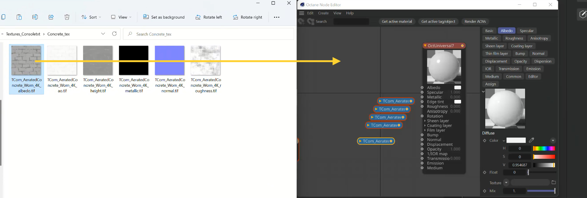

But, as suspected by Ahmet, if you drag and drop any of the texture, not on Material node, but anywhere in the Node Editor, all the textures are correctly imported, but not connected:

thank you very much, the error came from my side, indeed I threw the textures in the node editor and not on the material node. :roll:
