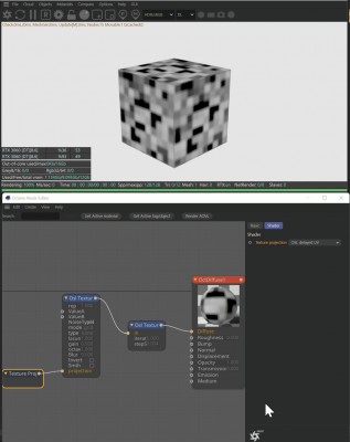

Posts: 10643
about OSL Gaussian Blur node, to make it works, you need to have a Projection node connected to the source texture, and change it to "OSL delayed UV":
ciao,
