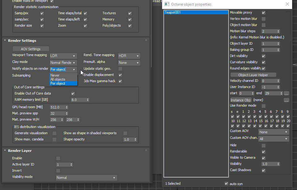

In the video, it doesn't show an important first settings:
In Render Settings, set Notify objects on render: Per object.
Then, in Object property, the 'Use Render mode' option should be available: turn it on to render 100% of hairs, instead of the "Preview Strand Fraction" percent from the Ornatrix settings (like in the HairFromGuide1 modifier)

Thanks NZ ! You save my day !
Yes it render fine :-)
"Use render mode" was the clue, but a little hidden ;-)
