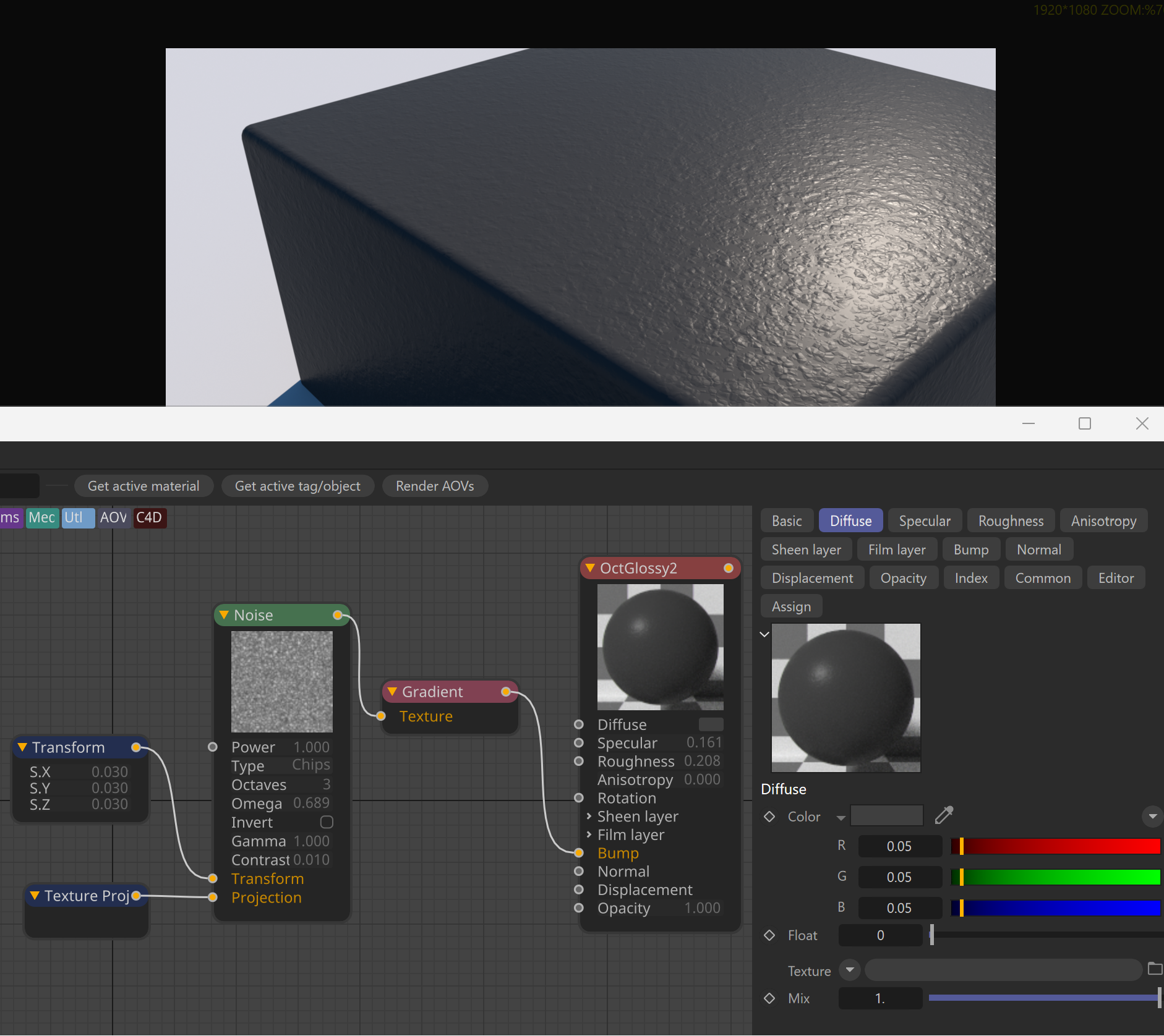

Yes, you can. Just make sure your texture projection and scale are appropriate for the scale you are woring. Here is a 10 cm cube with an approximation of your texture using Octane Noise. Here I'm using XYZ to UVW projection and a uniform scale of 0.03. I've also tweaked the noise output with an Octane Gradient and set the Bump value to 0.0003. Properly adjusted, it will look the same at 1 cm.
Small Scale Bumps
Small Scale Bumps
