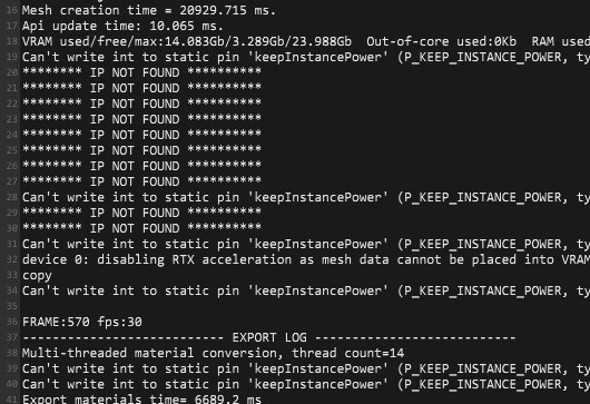

i have a big problem with my rendering projekt.
1. i can not login into forum account and must create new one, so i can not write into the support forum.
2. you see in attach, i become a error message "IP not found" and after that he rendering only black screens.
I am use OctaneRender Studio+ 2022.1 (12000020) on Cinema 2023.2.1 on WIndows with an RTX 4090 and RTX is active.

Maybe important, i want to say the black screen and render crash is gone after i delete the "active" key from camera motion blur.
i had made a key record from inactive to active the motion blur in my camera. Octane dont like it
