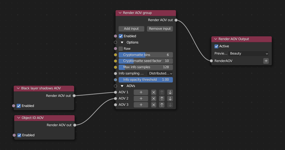

I can't find an AOV node for Denoiser Beauty. Any idea how I can add that pass to my AOV outputs?
Andreas_Resch wrote:Yeah. I'll stay away from those AOV editors for now. They are too confusing. Seems to be better integrated in Cinema 4D where there's just one AOV editor. Maybe it makes more sense there. As long as the Blender Compositor is supported, I should be fine.
linograndiotoy wrote:You can find the Denoised Beauty in the Octane Composite environment.
No need to add it to the AOVs, since is already selectable along with the Beauty pass, in the Render AOV Output node.
