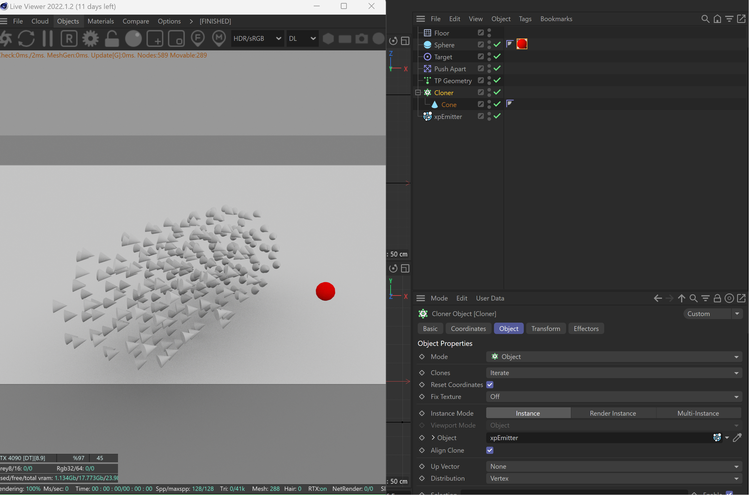

Instead of using Octane Object Tag particles, you might try using a Cloner to place geometry onto each particle location. You just need to drag the xpEmitter into the Ojbect slot of the Cloner. Now the cloned geometry is using the X-Particles data for initial location, but can be further modified with any of the Effectors. In this case, I've added a Push Apart to prevent collision/interpenetration, as well as a Target Effector to make all the cone particles point toward the red sphere.crasse wrote:I don't think I can use particles as source object for cloner in a typical xparticles setup, i'm using an octane tag on the XParticle emitter, and put geometries in the rendering tab (as shown in the capture),

Hi frankmci !
yes that actually a method that I came across in the past days, seems to work great ! however is there any difference in calculation method to calculate/display those geos ? anyway i'll test that method and compare with tag one, on a millions+ particles setup
thanks for the help
(this method also help when I want a different amount of différent geo objects as the tag method does not allow to put multiple occurence of the same object, I need to duplicate it in the scene to duplicate it in the list of the rendering tag tab in order to get various proportions of object, which is kinda stupid )
thanks for the help

I imagine that for simple particles, the Octane tag version will be faster, but for more complex geometries, I suspect it doesn't make much difference if you use Render Instance or Multi-Instance modes in the Cloner. As I understand it, Octane treats C4D Render Instances the same way it treats its own Scatter instances. But it's definitely something you should test for your situation.crasse wrote:Hi frankmci !
