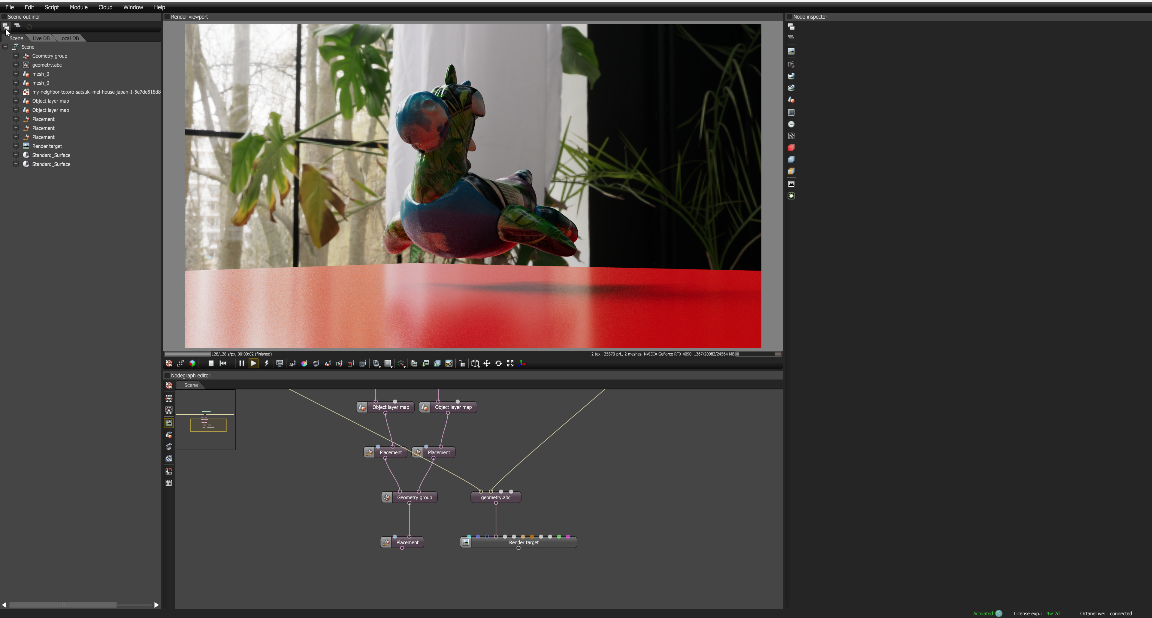

Here is my scene rendered with Octane + Solaris as EXR and Aces applied using DaVinci
Here is my scene rendered with Octane + Sops (not Solaris), this is correct and how I expect them all to look
Here is my scene in Octane + Solaris, as you can see it is overly saturated and a lot brigther than the image rendered to disk??
Check out the attached hip files! Thanks!

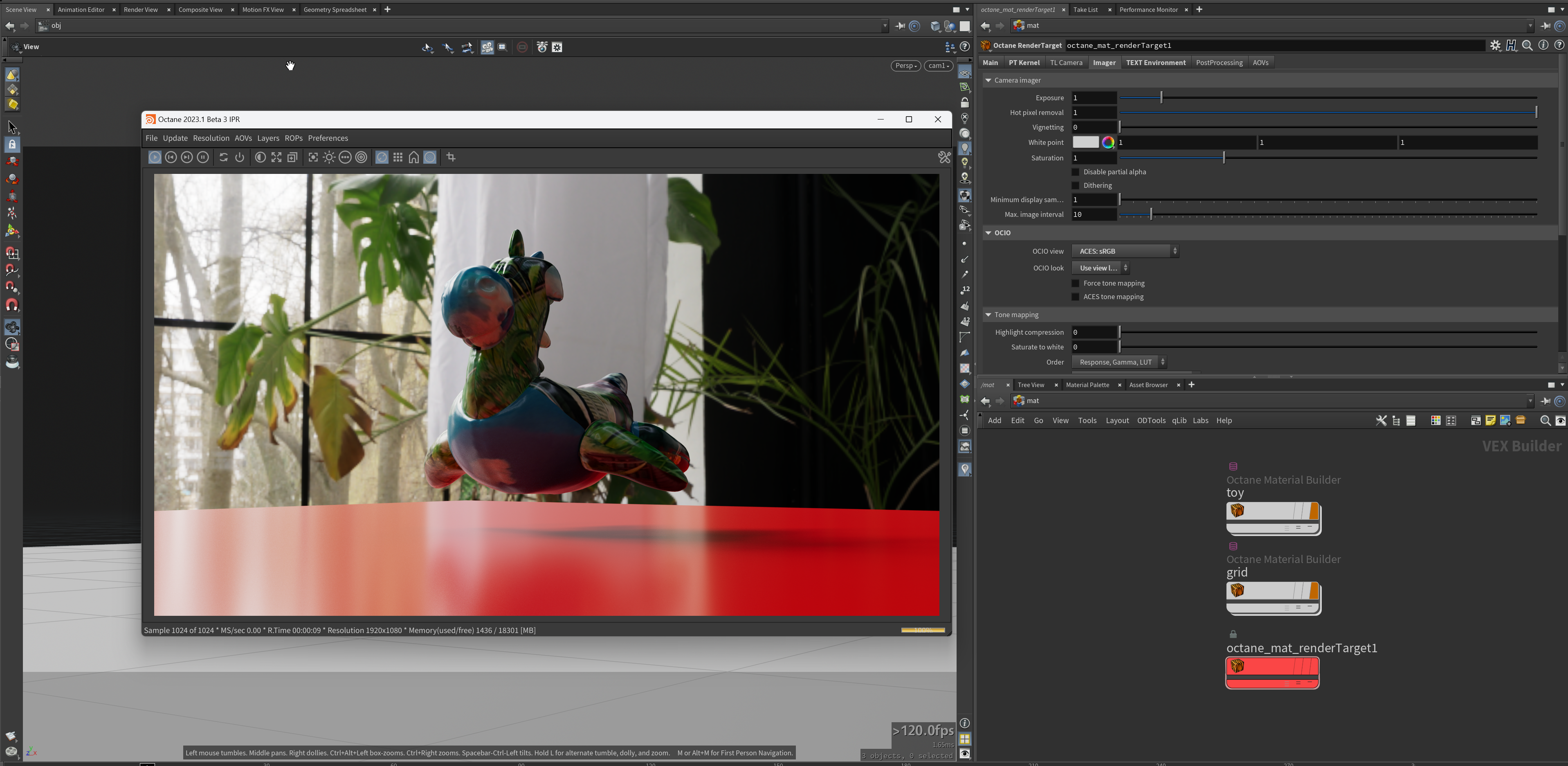

Here is a screenshot of the Octane-Solaris scene exported as ORBX and rendered with Standalone
As you can see it matches the render made with Octane in SOPs
But it does not match the render made with Octane inside Solaris
