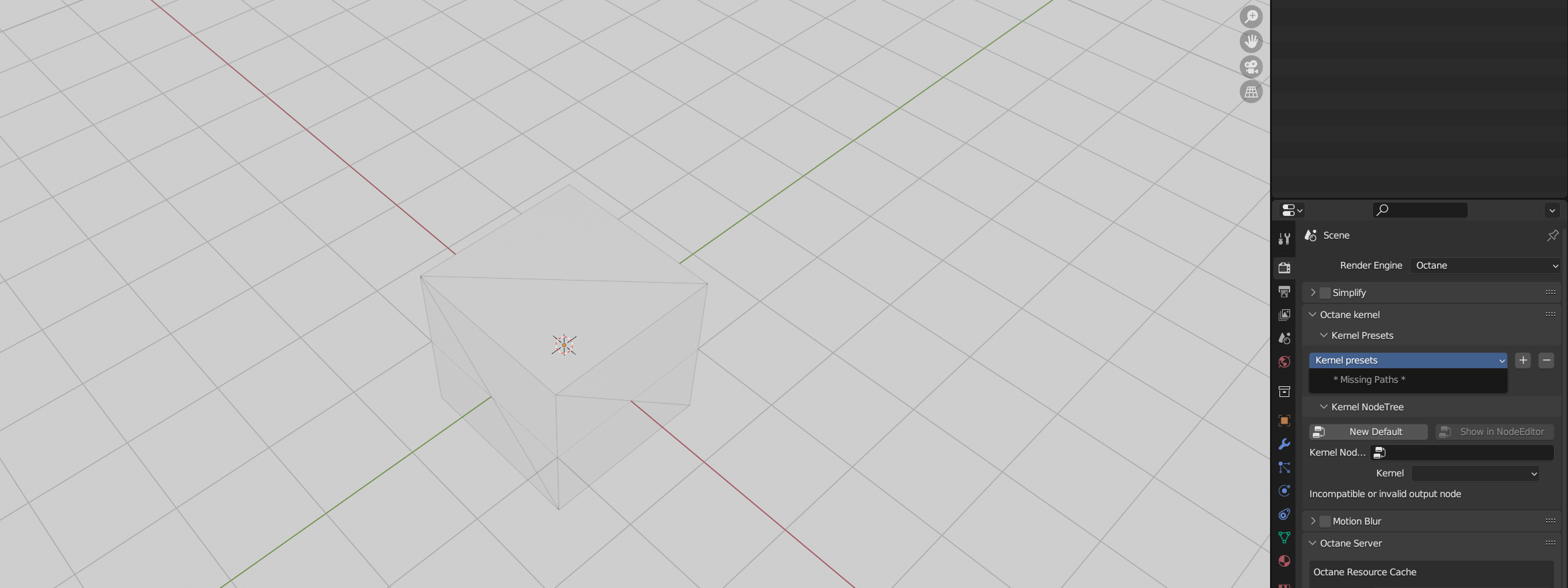

It is behaving weirdly. The viewport has a glitch when I orbit around the mesh. I get a L-shape half-black viewport. Also, I can not see any kernel options (check attachment please).
Additionally, the mesh shows wireframe tris faces when using the render viewport. I have also noticed that the Octane Server is running, but I have not "asked" for any login, like in the alternative version of Octane Blender. When I try to see if it's running, apparently it is, but I do not have any way to check more than my task manager. The icon on the system tray is unresponsive.

Hi, make sure you loaded basic document template for Octane first. It's located in File menu > New > Octane Default Startup

Thank you! It worked out. Do you think, eventually we will not need to do this?

As long as you set all the necessary options by yourself (Kernel and Color Management in primis), then no, it's not needed.
