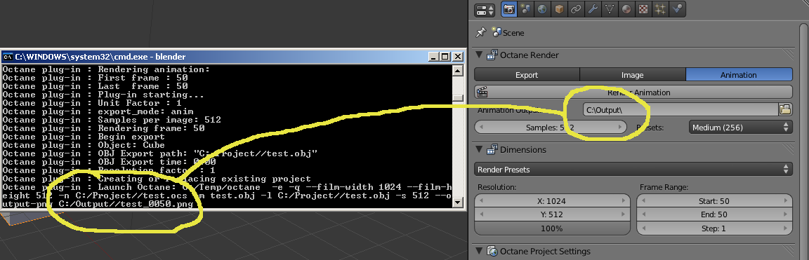

Re: settings materials for animation
Postby yoyoz » Tue Jan 11, 2011 6:18 am
yoyoz Tue Jan 11, 2011 6:18 am
The plugin is supposed to build the filename based on the following parameters: animation output, project name and frame number.
So if you have the following:
- Animation output: C:\Output (must be an absolute path)
- Project name: myproj (no path, no extension)
- render frame 25
the image should be C:\Output\myproj_0025.png
However, on Windows the actual parameter given to Octane is C:/Output//myproj_0025.png ("/" or "//" instead of "\"). Blenders accomodates well with that (I could check the obj and mtl files are properly created), but I don't know if Octane does too as I can't test it on Windows. I'm pretty sure I didn't alter the original code from Enrico for this part and was assuming it was fine.
In order to check, please start blender from command line, ensure verbose mode is on in the 'Octane System Setings' panel, render an anim and check the output from the console. The full command used to start Octane will be shown with all parameters.

Postby Sdados » Tue Jan 11, 2011 2:23 pm
Sdados Tue Jan 11, 2011 2:23 pm
first of all thanks again for the ready help yoyoz!
and second... stupid me :D i was trying to put the path+name of the file the animation output space. so that was the problem, now is working fine!
so thank you again and don't worry... ill be back soon with more questions :D
