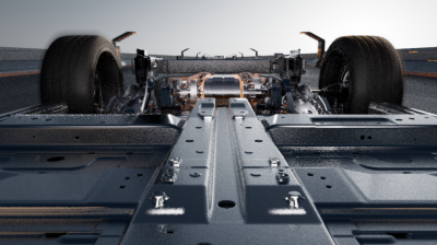

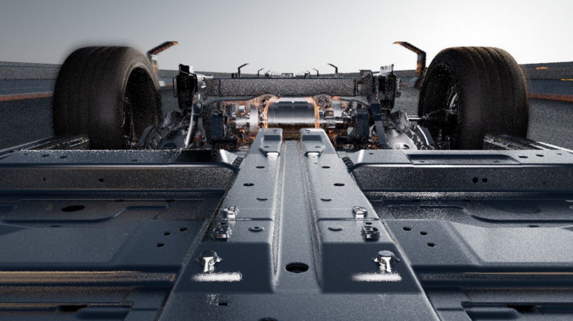

wheel and road well worked

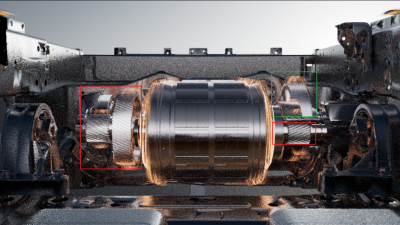

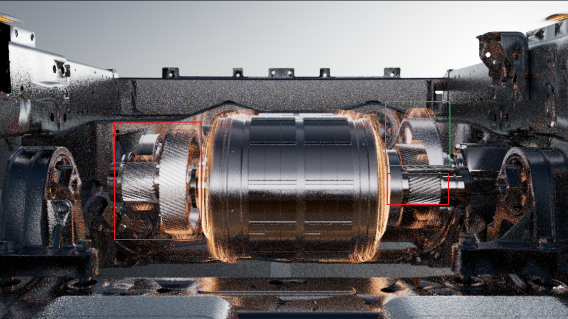

somg gears works but some were not

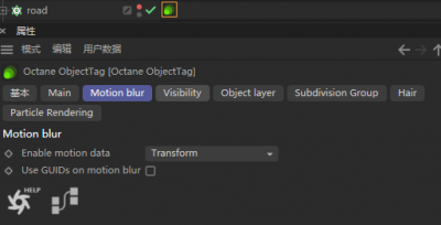

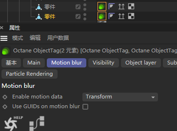

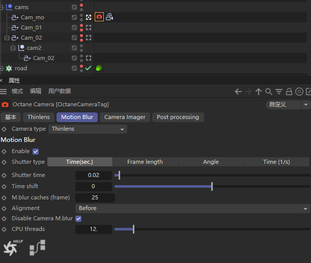

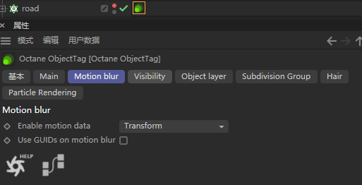

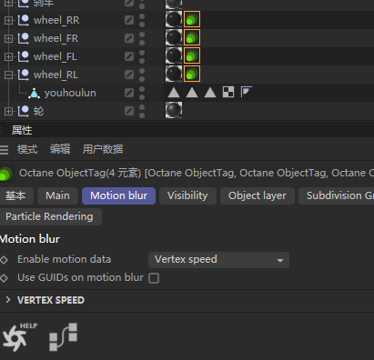

all my settings here

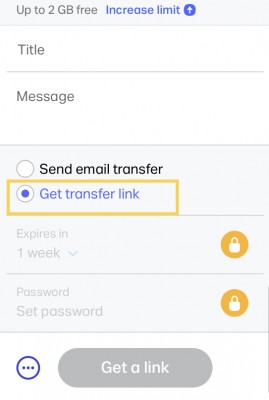

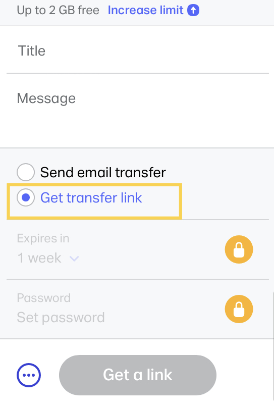

if the scene is too big, you can share a link via Wetransfer:
https://wetransfer.com/
