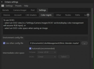

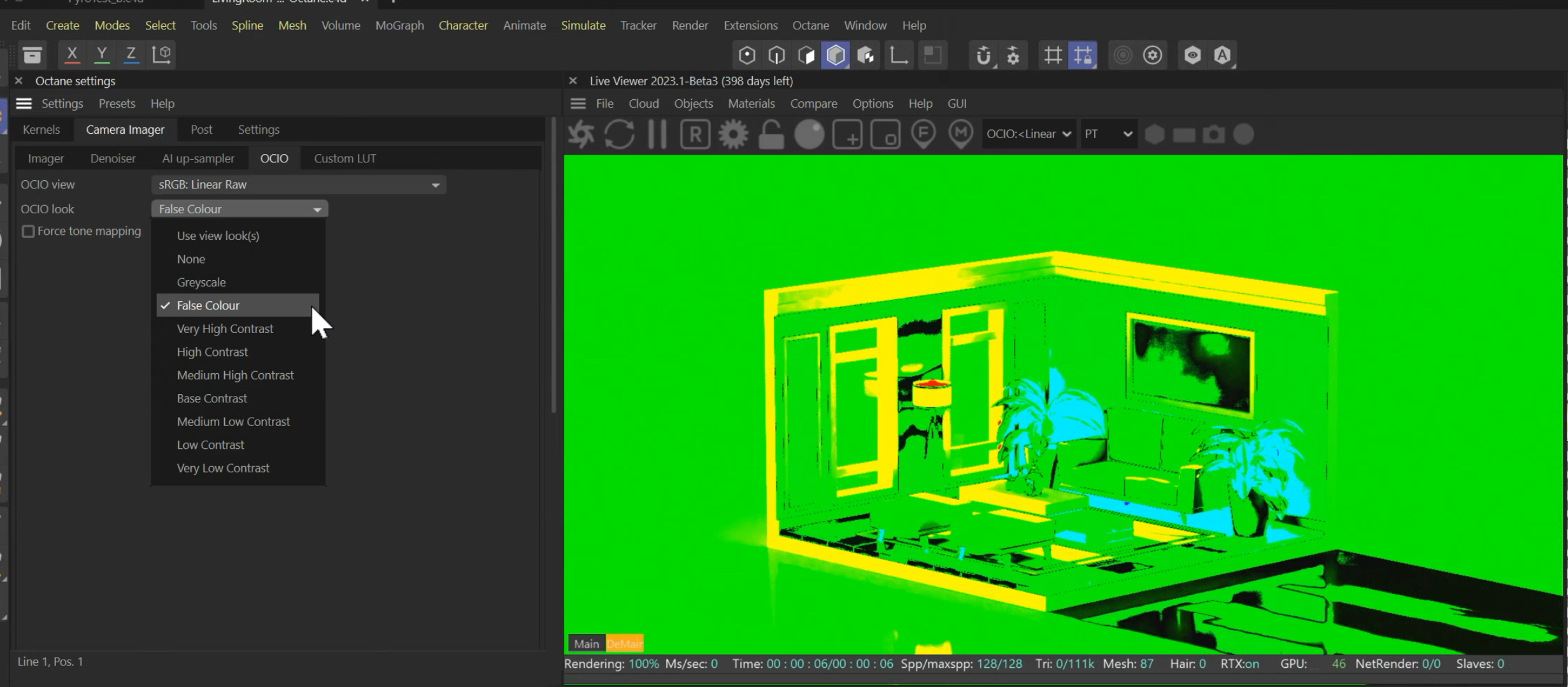

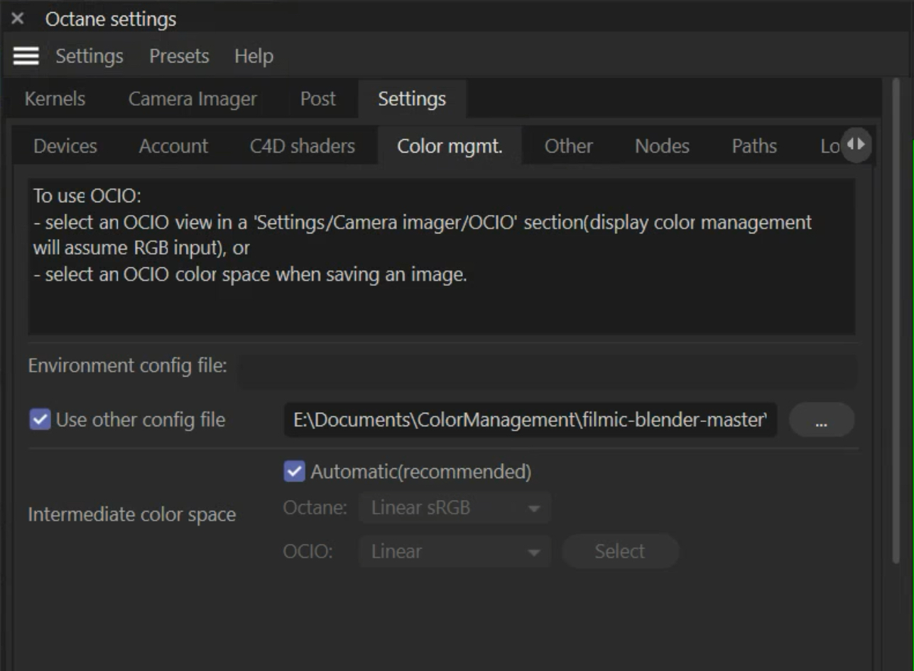

if you load the Filmic-Blender config in the Color Management tab:
there is a False Color option:

elsksa wrote:Beep’s suggestion.
A more recommended alternative based on AgX (Filmic being deprecated) is available as a fork, includes false color.
Worth mentioning the enormous range of an offline renderer output (EXR when encoded to a file, as low as 16 bit floating point). While there are reasons to utilize a “false color”, it isn’t an absolute necessity since nothing is “blown out” or “lost” with the aforementioned file format encoding.
