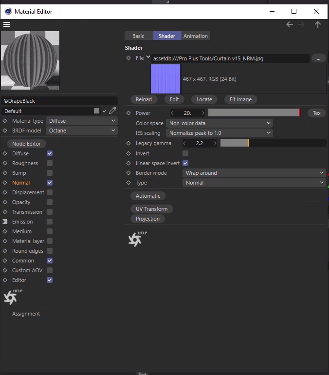

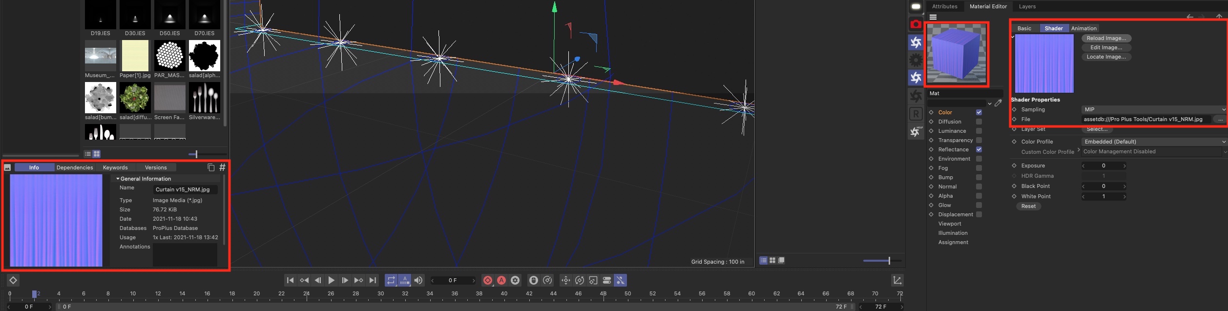

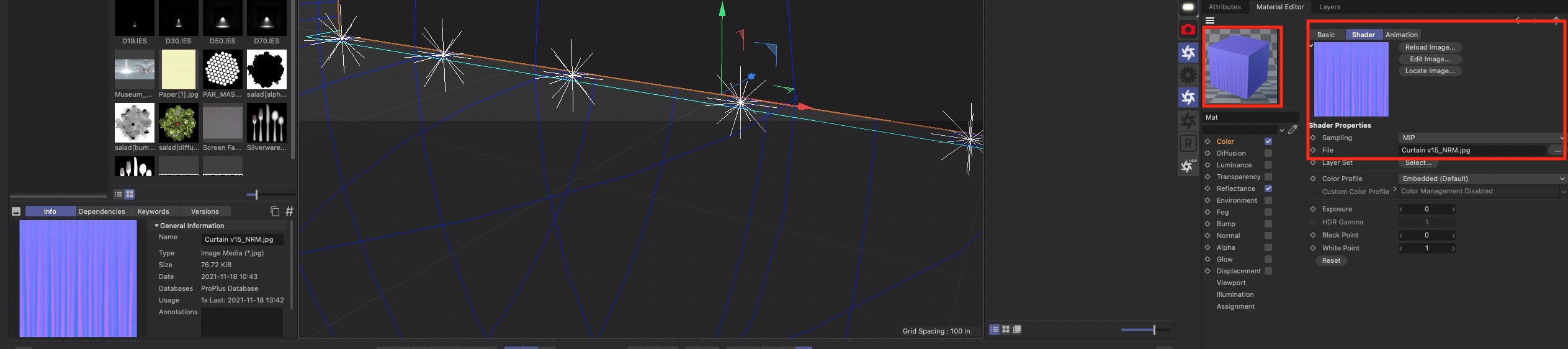

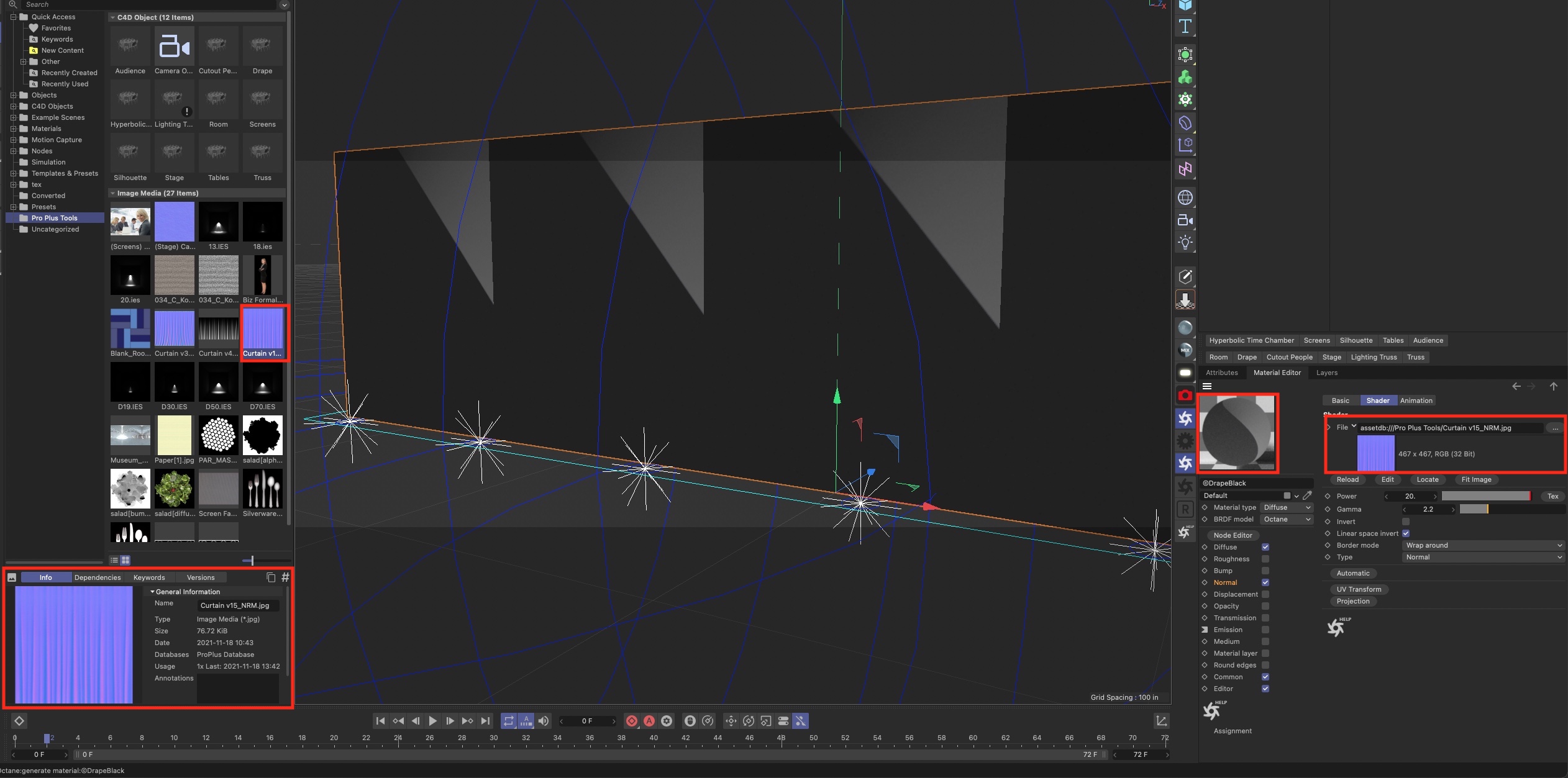

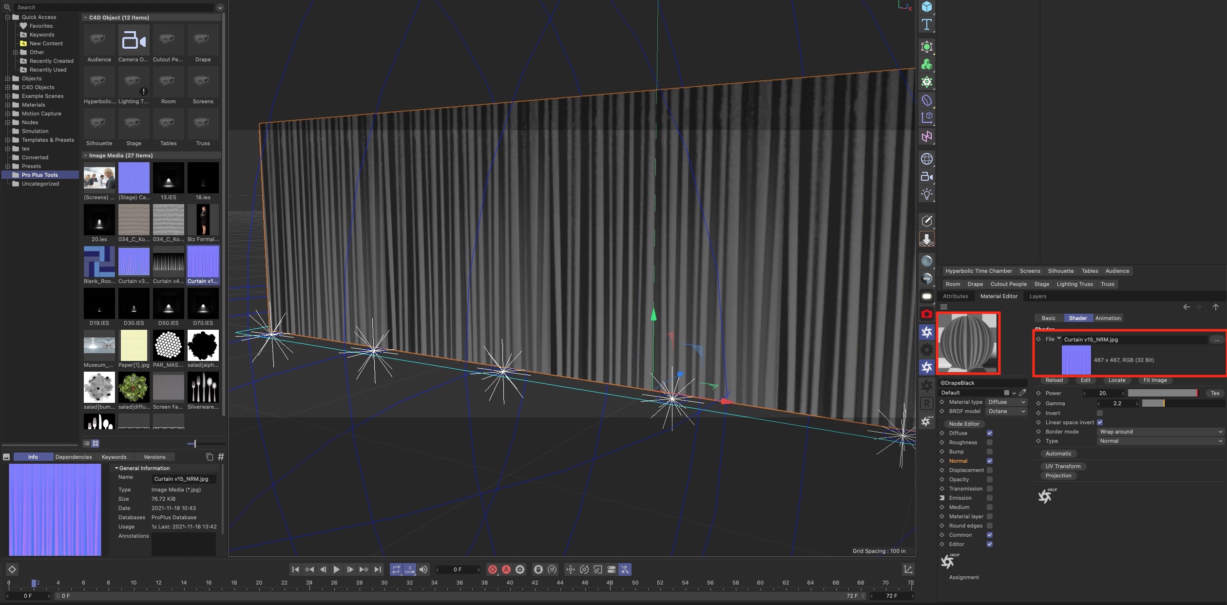

Asset texture images don't work on Mac for Octane Materials, the same database on my PC works correctly for Materials.
Asset textures DO work with C4D materials.
Octane Material - Asset Image
Octane Material - File Image
Octane Material - Asset Image Windows 10 PC
C4D Material - Asset Image
C4D Material - File Image

Yes because of it's still on 2020.2.5 core. I cannot add anything new. But It will work when we have a new SDK which is matching 2021.x or later.

Hi there, is there an update on if the asset browser textures should work now? Or are we still waiting on mac for SDK update? Thank you!

New SDK is out, we'll do it with newer versions.

Amazing thank you for the update, so using PR14 should solve this? Thank you!
Posts: 10549
No, PR14 is still based on 2020.1.5 SDK.
We need to wait for the new upcoming version based on the new 2022.1-XB1 SDK or greater, to have both Metal and CUDA versions in pair.

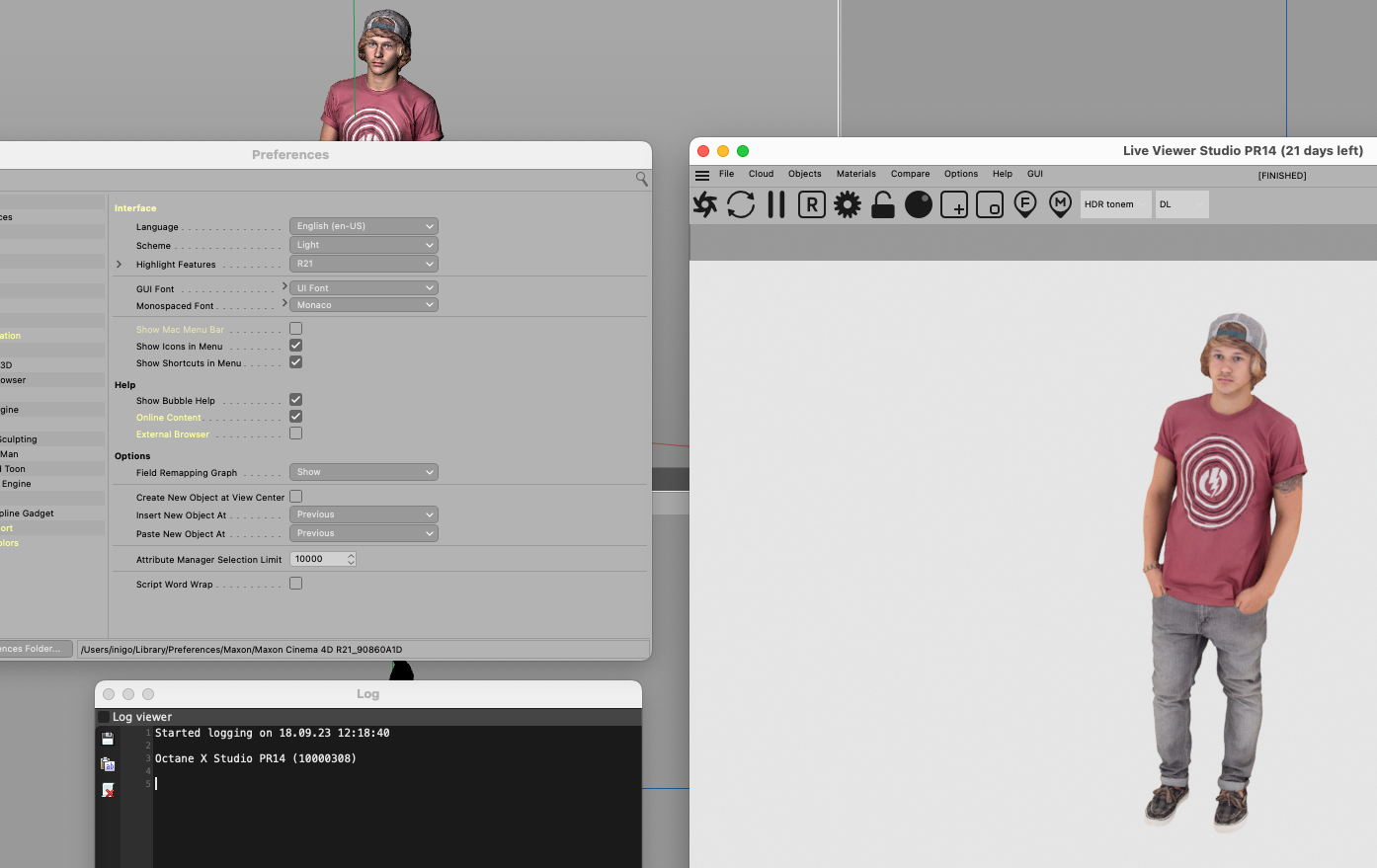

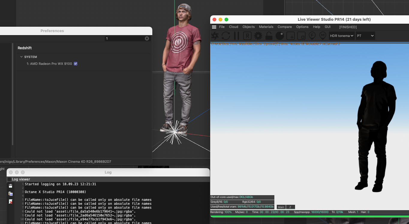

Hi Beppe, I am having this issue with the asset browser objects, textures are not rendered. Is there a way to fix this?
C4Dr26 + Octane PR14 = NO RENDER
C4Dr21 + Octane PR14 = RENDER OK

have you tried to save the project with assets, before loading the scene in Live View?
ciao,
Beppe
iRota
Posts: 45
Joined: Fri Mar 01, 2019 10:02 am
bepeg4d wrote:Hi,
ciao,
Beppe
OK, yes Beppe, that works. :shock:
I do not normally save scenes with assets, just "save scene" so I am not familiar with this particular workflow.
