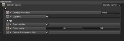

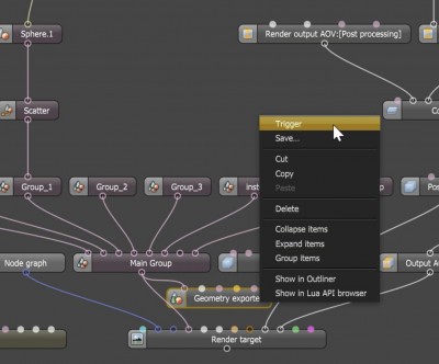

you can change the type of all c4doctane materials to Universal material, then export the scene in .orbx to Standalone, then use the Geometry Export node connected to the Main geometry group:
Define the saving path, and enable the material export, then right click on the node and chose Trigger:
