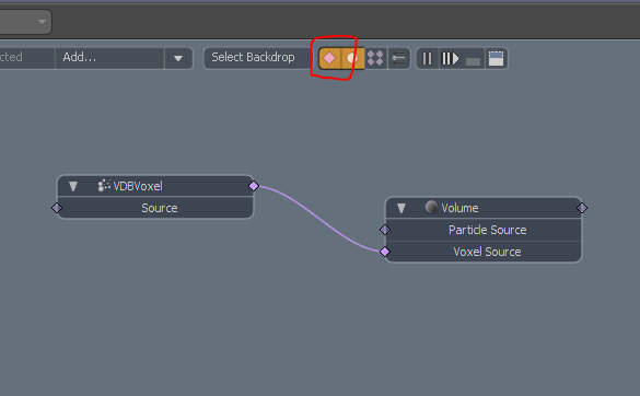

Specifically, when we create a workspace and bring in both Volume item and VDBVoxel items, there's no way to connect them if you alredy have any octane overides.

Paulbrownv wrote: I'm trying to render a static VDB but the steps that are in the documentation no longer work. :(
It sounds like you might just have the "show item relationship" toggle disabled.
Older versions of the plugin would unintentionally toggle this off when overrides were created, but I think this was fixed at some point.

Gosh I knew this had to be something very simple, thank you Funk!
It was the "relationship" toggle you mentioned.
