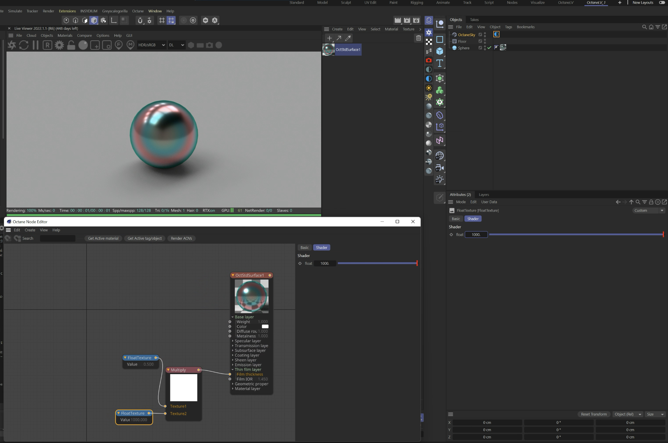

Film Width can not work On standard surface materials

I don't know how to make him work properly in the latest version.
I tried several versions, but they all didn't work.

Standard Surface material uses a different nanometer scale for Film Width, while Octane uses micrometer scale, so the solution is to use a Multiply node to multiply the Film Thickness by 1000:

bepeg4d wrote:Hi,
ciao,
Beppe
thanks :D
