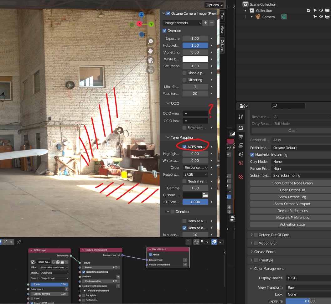

my question was more in regards to that the add-on version of octane does not seem to behave the same way as the custom build blender. in the viewer panel, toggling the ACES tone mapper doesn't change the image at all and the viewer does not look properly color managed (like it does with the custom build, please see screenshot). so now i have two questions:
- how can I use the config you posted above with the add-on version
- how can I set up the add-on version so it behaves the same way as the custom build in regards to color
many thanks

You have to load the "config.ocio" file in the addon settings of Octane (screenshot below). After that you can select the various options in the OCIO sections of the Camera Imager or Preview panel.

thank you very much - took me a few attempts for some reason, but I finally got it to work.
Again, the config you posted above is golden - perfect for Vanilla Blender too as it weeds out all the bazillion color transforms that come with the standard ACES package.
