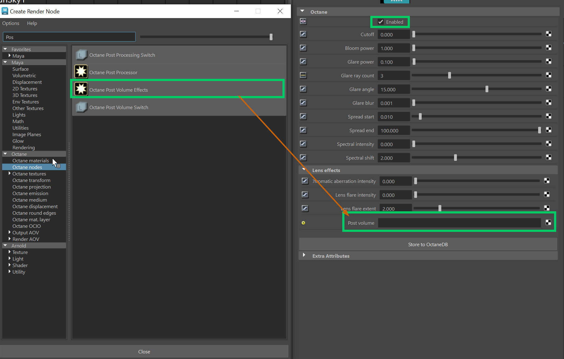

Where would the settings be for fog?
Edit: I found the Post Process Volume Node, how would I use this node for fog? Where would I plug it into?

g0ll4m wrote:Where would the settings be for fog?
Hi G0ll4m,
please try plugging the Octane Post Volume Effect node under the PP node>Post Volume pin like the image below.
[img]
[/img]
It looks like the Postfx AOV is still missing with this build. We will implement it in the next release.
cheers

Ah, this is it! Thank You.
