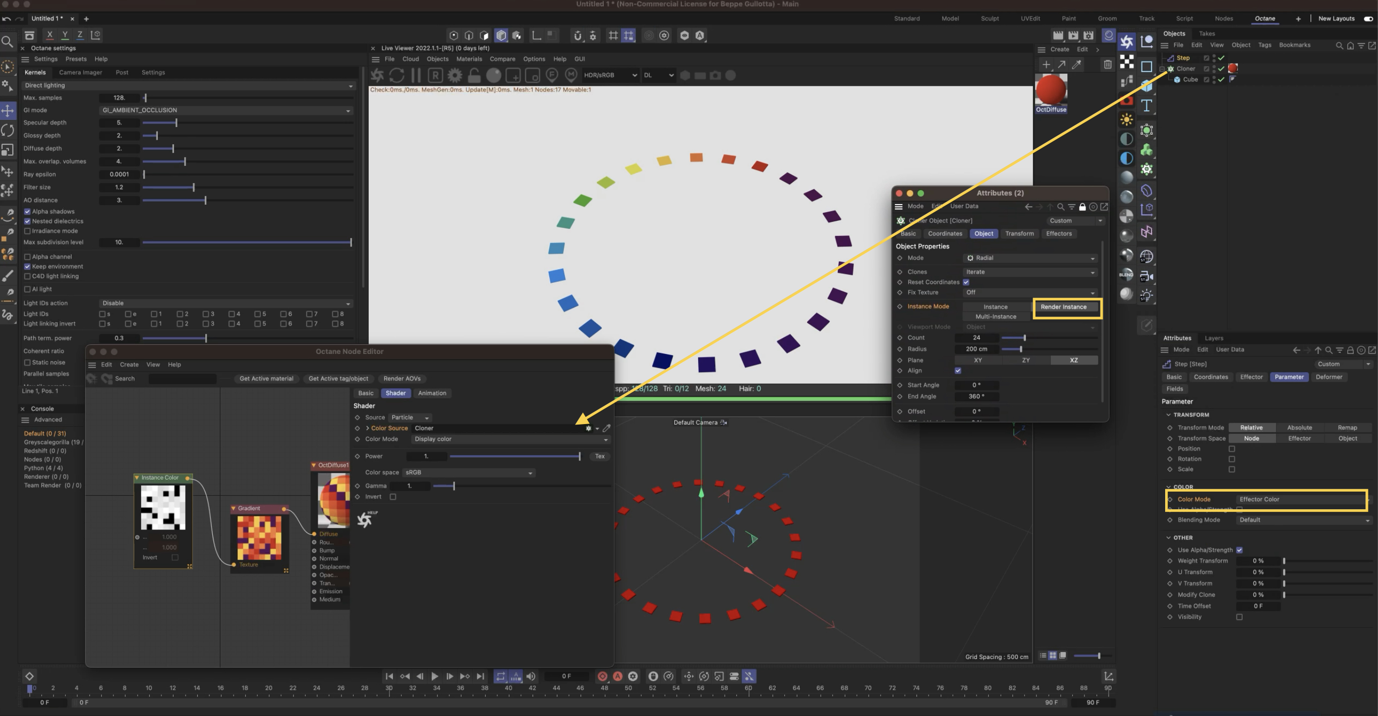

first of all, you need to set the MoGraph Cloner to Render Instance mode.
Then set the Step effector color mode to Effector Color.
Then use the Octane Instance Color node, and drag and drop the MoGraph Cloner in the Color Source field.
Finally use an Octane Gradient mapping node to assign the desired gradient colors:
Here is the scene:
MoGrapgInstanceColor.zip
(98.01 KiB) Downloaded 280 times
ciao,
Beppe

Thank you for picking this up and taking time to create the scene file. I had it figured out right after I submitted the post. It seems like my Octane was acting up, oddly it worked after I copied everything onto a new scene. :?
However, my setup worked this time by using the MgColourShader node and gave pretty much the same result. I have looked at your setup as well and it also makes sense, are there any significant differences in using the InstanceColour node vs MgColourShader ?
Also, at a first glance - i switched between Instance > Render Instance > Multi-Instance and realised nothing really changed (in terms of colour distribution I guess). Perhaps it makes a difference in more complex setups.
Nonetheless, it worked! Thanks. 8-)
