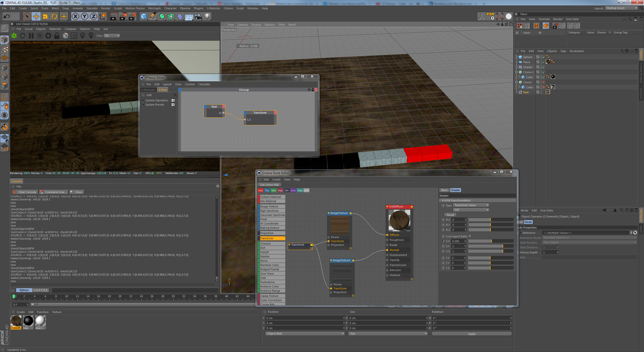

Yes just a simple xpresso setup is enough for that.

shall i drag the transform node into xpresso or how can i adress it?
thx mate
Posts: 16068
Location: Türkiye
like this. Drag and drop is enough.
