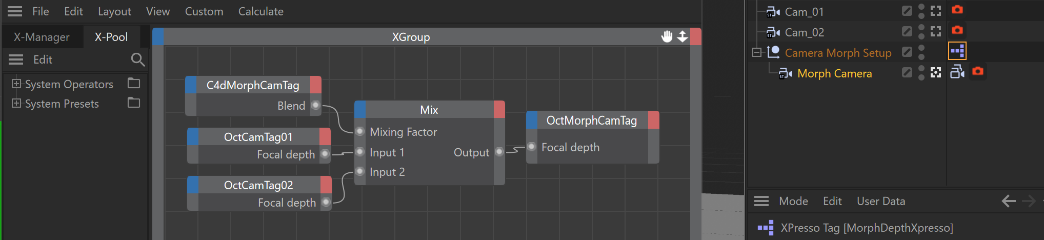

This may not be the most elegant solution, but it works for me.
The issue is that the C4D Camera Morph Tag does not have access to the Octane Camera Tag attributes, just the standard C4D Camera attributes. To get around this, I feed the Focal Depth from both source Octane Camera Tags into a Mix node. The mix node is driven by the Blend value of the C4D Morph Cam Tag. The output of that Mix Node then goes into the Focal Length of the Octane Morph Camera Tag.
Another way to say it is that while the C4D Morph Camera is still handling all the 3D transformations, the ExPresso Tag is taking the Blend information from the C4D Morph Cam, mixing the Octane attributes the C4D Morph Cam can't access, then feeding the results to the Octane Camera Tag on the Morph Cam.
I hope that makes sense.
C4D Cam Morph with Octane DOF
