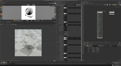

I'm having problem with Extra Roughness setting for transmission section in Standard Surface.
I also tried Octane Standalone and Octane X on iPad, nothing gonna happen when I changed that setting up and down.
Is this a core problem with Octane on macOS and will it gonna be fixed soon ?

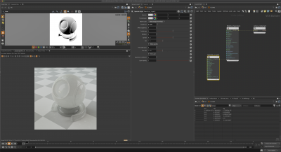

I want to archive the simple cloudy look inside object like this image below with standard surface extra roughness that works normally in Redshift.

As far as I can tell it works fine on Windows, so this might be a Mac-specific issue. If you have a simple standalone scene that shows the issue I recommend you post in the General Support forum (viewforum.php?f=23).
