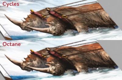

In one of my recent render tests I also saw that some textures were a lot more blurry in Octane than in the same rendering done in Cycles. Even when setting the Octane pixel filter to 1, the textures were quite a bit more blurry in Octane. In product shots where you have small text on labels, this can make a difference sometimes.
Here's a comparison between Cycles and Octane. Pixel filter for Octane was at 1.05.
There has been discussions for more filtering options at texture level.
Meanwhile, an OSL node can alleviate that.
