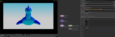

Octane output ignores the render resolution.

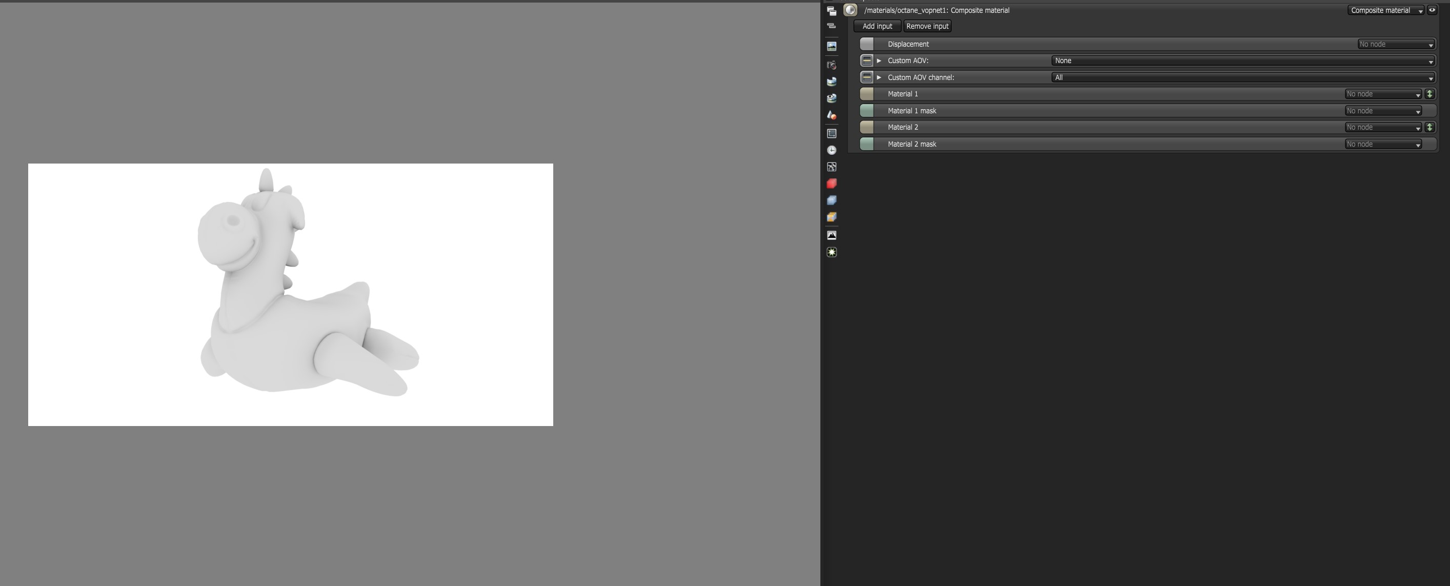

It seems that the composite material isn't being correctly exported via usd since when loading it it in Standalone, the materials are missing. It works fine when loading it straight back in Solaris.
