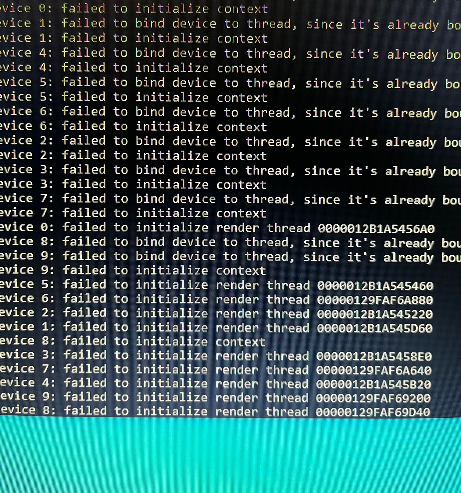

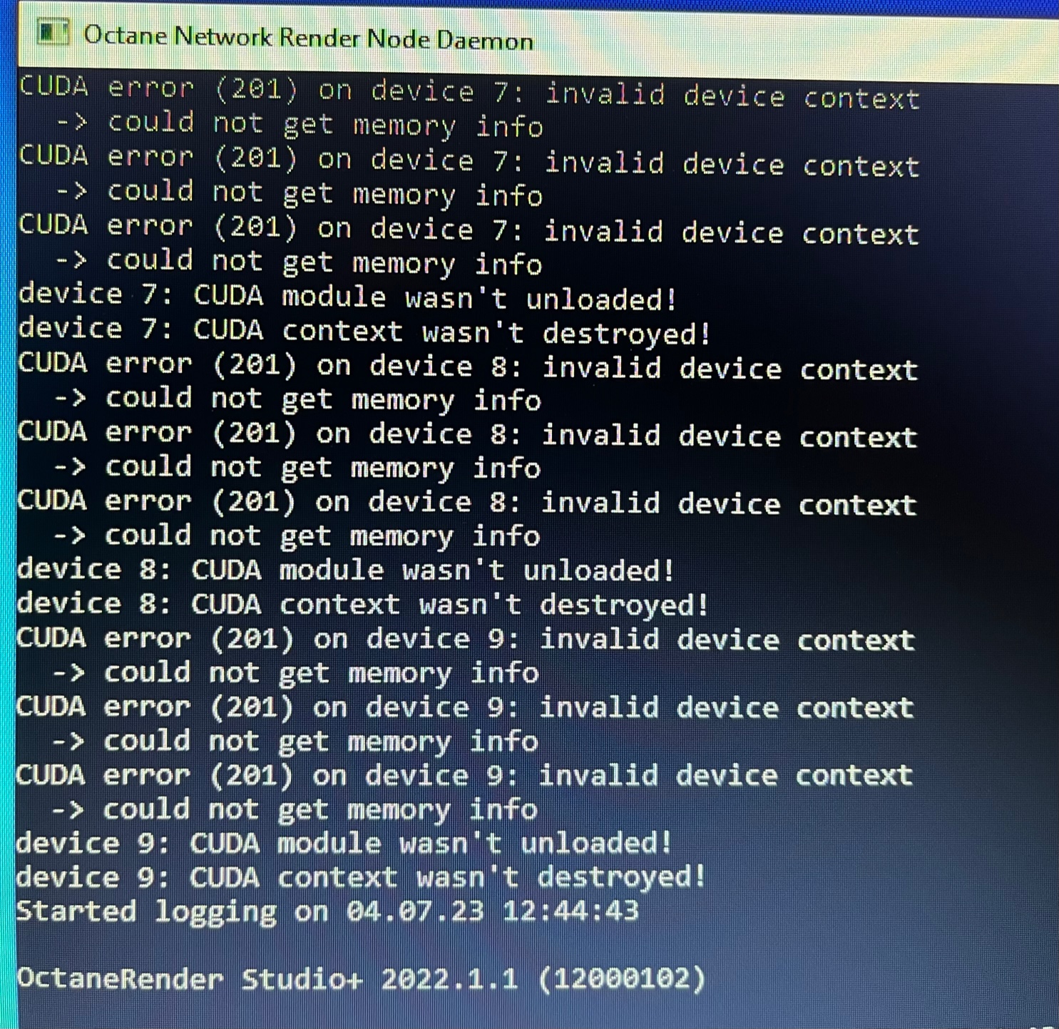

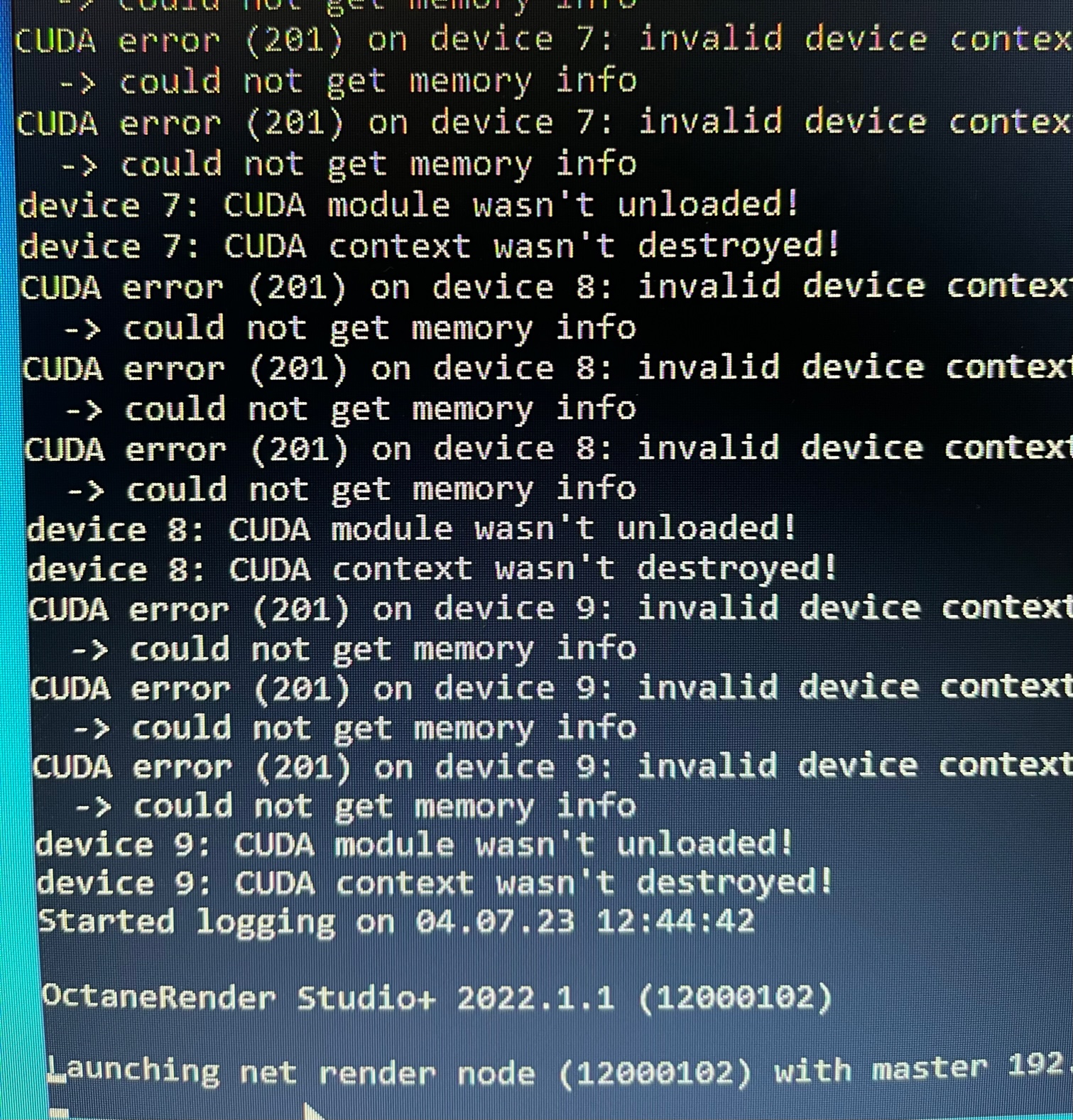

There is still a bug with out-of-core memory and slaves. On my master GPUs I can easily go over and have 5-7 gb ram used for out-of-core. Slave GPUs (each PC holds 10 GPUs) crash saying no memory even though each slave has 16 gb for out-of-core assigned to them. All GPUs have same vram size. is it a bug? Thanks
PS Here are the error slaves always get

Could you please to try setting up the Octane Daemon again, making the same setting for each render node?
In any case consider that just like in a multi-GPU setup, in network render, the amount of RAM available to OctaneRender is not the total amount of VRAM from your GPUs, but it is the amount of VRAM from your smallest GPU.
