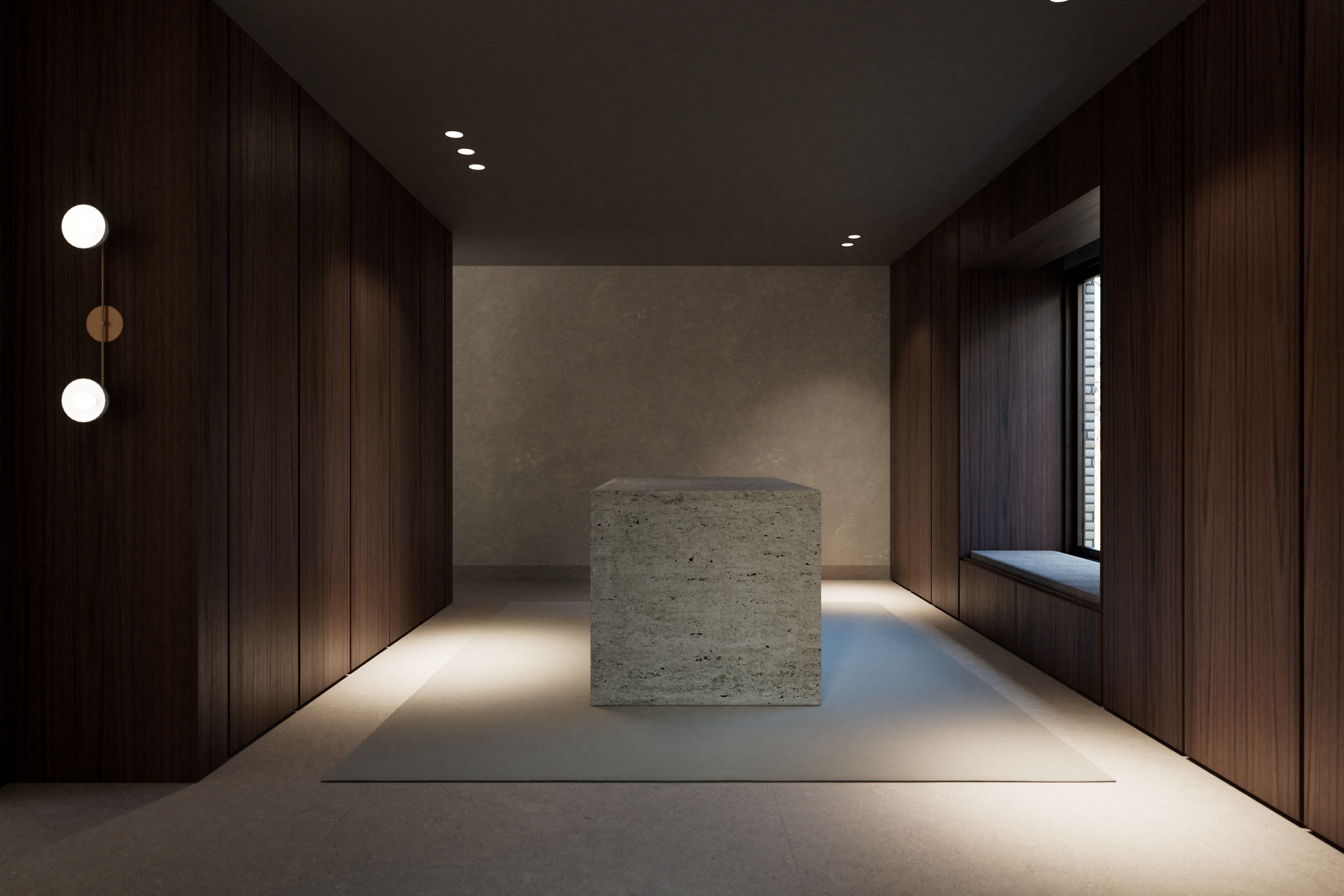

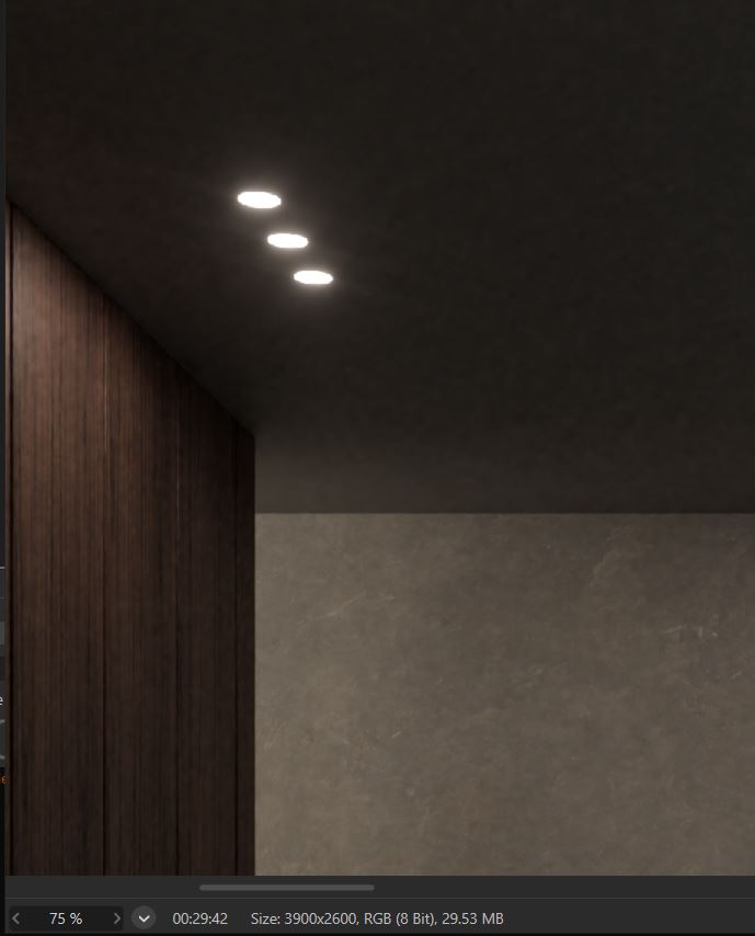

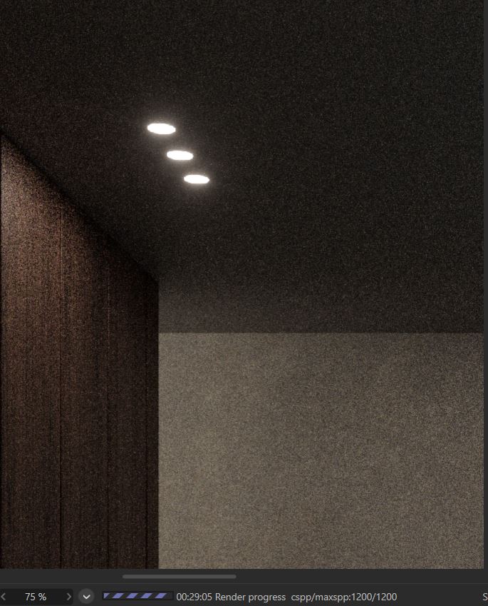

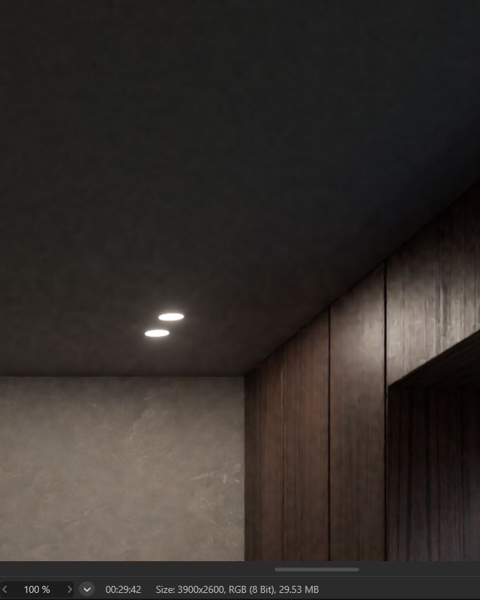

I have attached some samples of the noisy render before and after denoising from a work in progress. Furthermore, two finished renders of the same file, same model and same materials but one in a dimly lit scene vs one which enjoys more environment light. The output of the brightly lit scene is satisfactory to me (and took half the render time).

IES helped quite a bit on the noise! Furthermore, it reduced my render time from 60 minutes to 26 minutes. So I can comfortable increase samples to get an even cleaner result. Last but not least, it looks much more realistic. Good stuff and fun to play with different IES files. I've attached the improved image.
