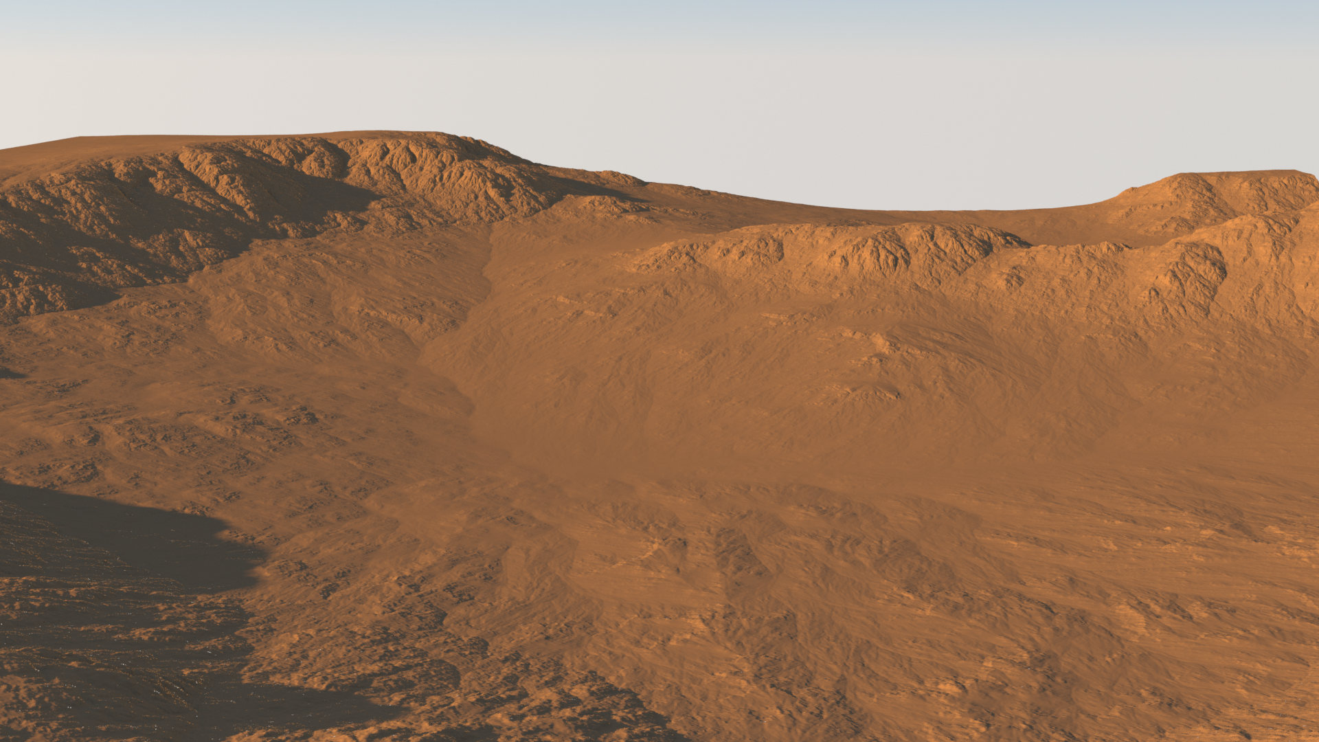

All I do is set up a scene in WC 2022.2.1 and when I like it, I export "all" from the third tab. If you import the .orbx or .ocs they come in fully textured but you can't texture them. (at least I can't)
But once unpacked in Octane standalone, it gives me a greyscale.exr and a bunch of numbered .pngs and this is what I use as my base displacement texture (the .exr). I use it in the displacement node any where from 100cm to 300cm.
I've attached two shots...one from the exported orbx, and one from the plane with the displacement material I made (red diffuse and .exr as displacement). You'll see the terrain is pretty similar, but it would have taken a while to re-create the look using all their numbered .pngs. But this is how I figured out how to do it.
Here are the pics. Hope this helps. Adding an Octane object tag with a subdivision value of 1 or 2 helps.
Yeah, I can get it pretty close, but I wish Displacer could use Octane textures, then it would be perfect. Thanks again for all of your help.galleon27 wrote:Create a separate plane with a displacer modifier and use the texture to displace the mesh. Use that displaced mesh for the collision for your simulation.
