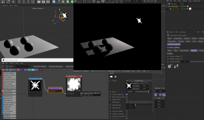

- HDR using in Texture slot... render comes very noisy and 2-3x render time. HDR fit auto in light size.
- HDR used in Distribution slot... it fast and much clean render but pain to set hdr with transform in light size...!
- Emission / backbody emission also very noisy.
For best to use HDR in Area light with auto fix in light size...?
Thanks.
HDR in Area Light
