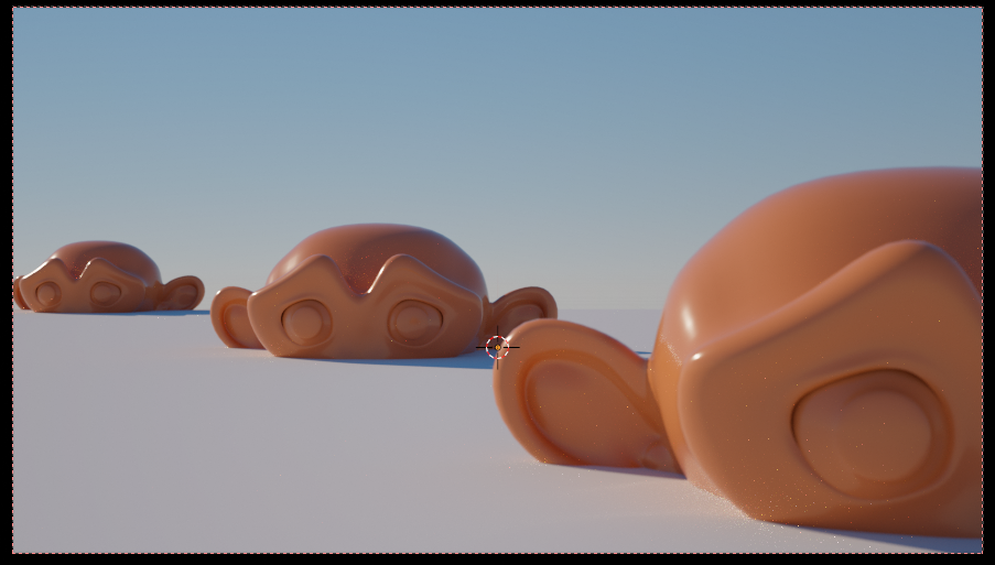

This is what I'm noticing: When I'm on the view port render mode and I zoom in on a part of the scene that's not in focus, the rate at it which it is defocused increases seemingly proportional to how closely I zoom in with the mouse wheel.
I've never had a physical camera where I can change the aperture or fstop so I don't know if I'm missing something basic, but I feel like this is not how it should behave. I've even tried this with cycles and the amount of blur on defocused areas of the screen appears consistent no matter how much I zoom in to the defocused areas of the scene.
In the image attached below, please note how much the monkey in the back is blurred

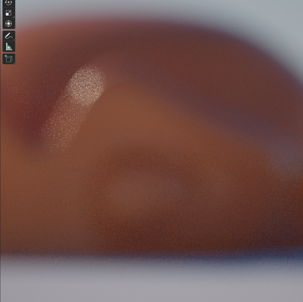

The image below is when I zoomed in on the monkey in the back with my mouse wheel. See how much more it has been blurred

this seems real world behavior: the depth of field becomes significantly shallower if the focal plane is really close to the lens/film back. i.e.: an aperture of 2.8 can mean a fairly deep depth of field when the focal plane is far away. when using the mouse wheel, you're not zooming in, but rather you are moving the camera (assuming 'Camera to View' is checked), and thus narrowing the depth of field as you get closer to the focal plane (your cube)... a real world camera behaves the same. hope this helps
I did not have Camera to View set. So when I was zooming in and out, the position of the camera wasn't changing. The only thing that changed was how big the rendered area looked on my screen. Also, I noticed that this behaviour does not happen when I enable "Used as Universal Camera". I like that this option has way more variables for me to tweak than before. So I guess I don't have this issue any longer?
