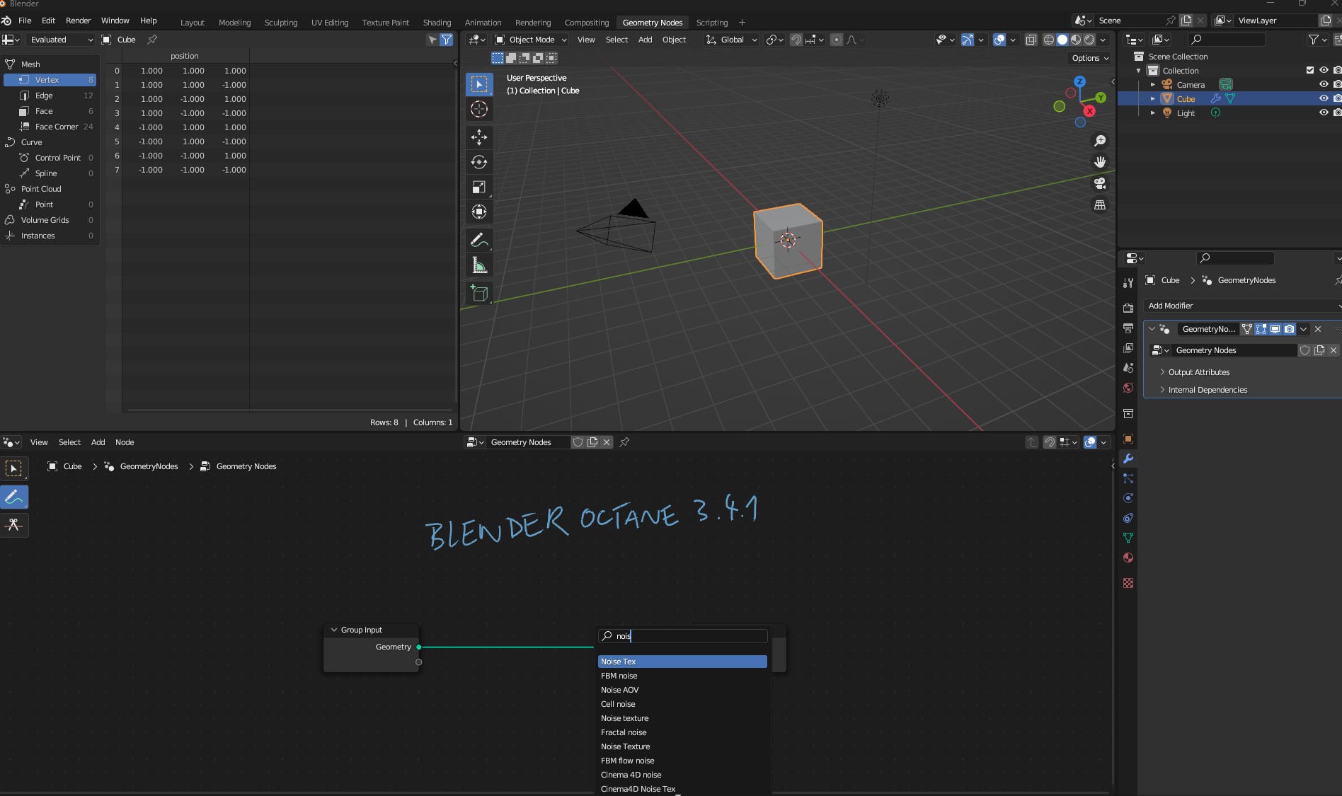

can reproduce crash 10/10:
- launch Blender_Octane_Edition_2022.1_27.12_stable
- create GN nodes modifier on default cube
- call noise tex in GN -> 100% crash to desktop
win11, 3080ti, 64GB
calling noise tex in geometry nodes crashes Blender_27.12
C. RAM Capacity (i.e. 6 GB)

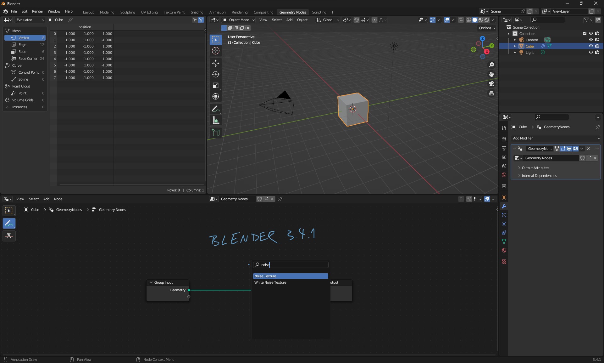

upon further digging, I think it's more a bug in the search menu which gets littered with octane nodes even though I am in the GN editor. (see screenshots)
the "Noise Tex" (that only shows in the search menu) makes blender_octane crash, the "Noise Texture" from the node menu behaves fine.
"Noise Tex" however does not appear under the octane nodes (it's called "Noise texture")
I checked against the native Blender 3.4.1 and "Noise Tex" does not exist at all.
So I reckon this is some redundancy/double up/legacy - also odd that the octane nodes show under the geometry node editor. it's been like that for a while - is there a fix in the works?
thanks!
thanks!

That's been fixed internally already.
