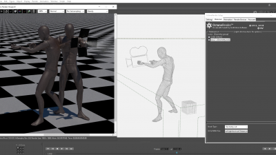

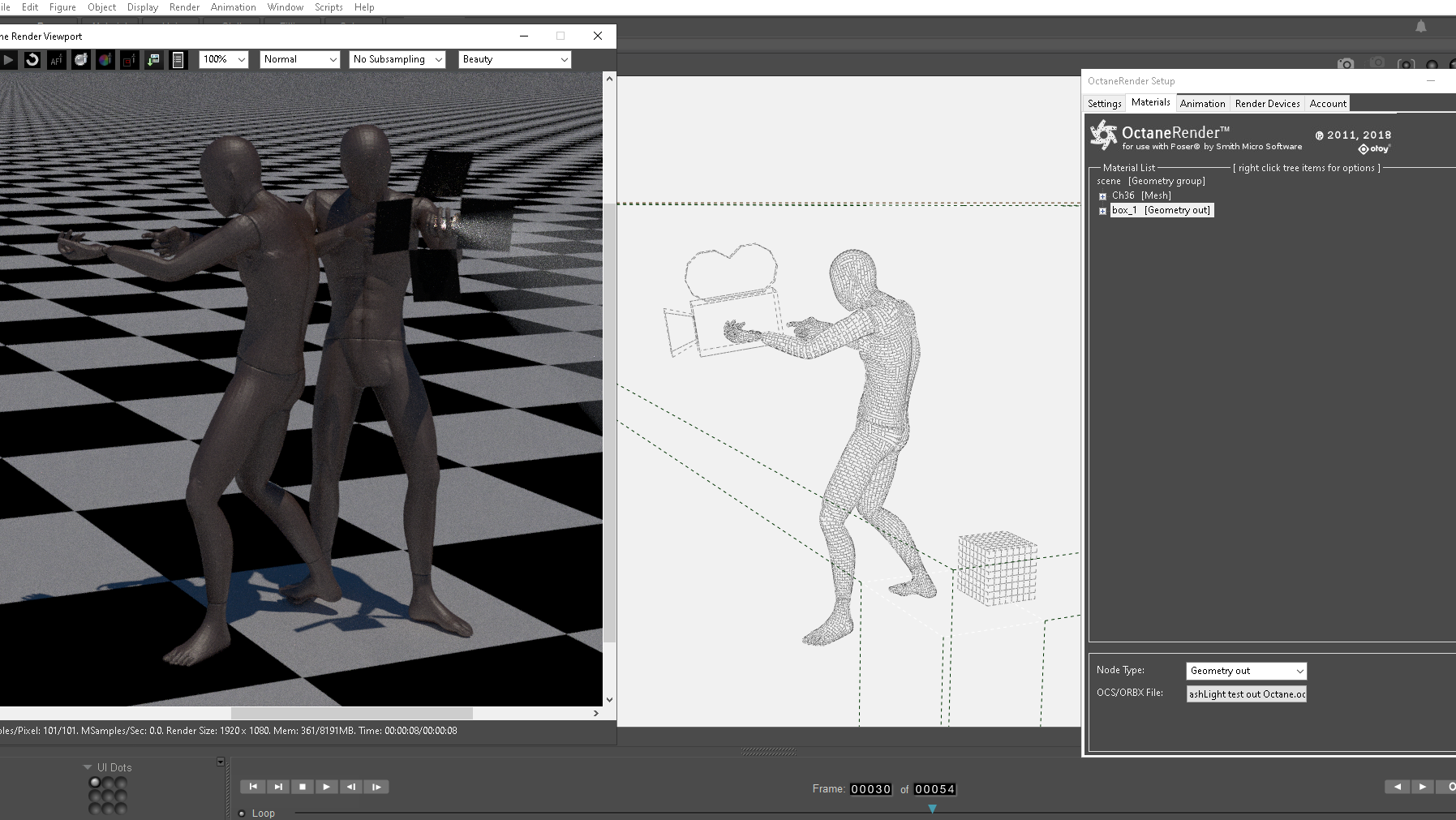

Sorry, I wasn't clear at all. I mean when I used the geometry out feature in the poser plugin. To get a standalone octane seemed. Into the poser plug-in. I don't see the animation playing. It just stays on the first frame.
In the screenshot, you can see. The animation I have in poser. I originally exported it out using the octane poser plug-in so I can open it into the octane Standalone app. I opened the octane standalone file and attach the geometry out node. I saved it and the animation plays in the standalone. But when I use the geometry out feature in the plugin on the Cube. The animation does not play at all. It stays on that single frame. As you can see I'm like on frame 30.

If you click the Animation tab->Camera Motion Blur checkbox, it will turn ON the Octane timeline and the Geometry Out proxy should then animation. I have added this info to the tooltip of the "OCS/ORBX File:" button in the next release.

Thanks it worked
