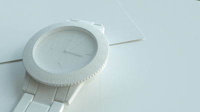

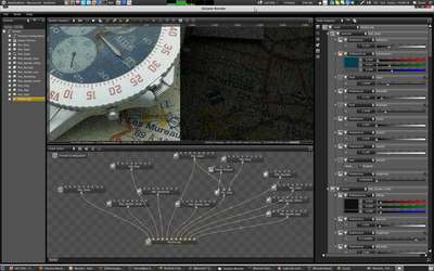

I'm now having twice the performance when using both chips since I'm using beta instead of demo version, but I still have a black line in the middle although it tends to disappear when increasing the number of samples (see my post in "Work in progress"). This only happens when using both chips.
I've attached a clay render so you can see. As I was writing I made another test an got an even stranger result (screenshot attached too).
