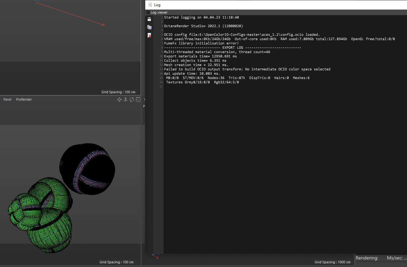

Hey all,
I'm facing some issues to render in Octane 2022.1 - R10.
It seems like an Acer/OCIO config problem by looking into the log file but I'm not sure.
You can find the .c4d file attached as well.
I'm using Octane studio plugin for C4D R21.115.
https://www.dropbox.com/t/Fz6iABkXMqbS7kOM
Any inputs on that?
Daniel

Seems to be render settings related. It is recommended to leave the "Automatic" checkbox enabled.
For more Octane ACES information, this page covers the subject and its content is applicable to Octane plugins as, universally.

For c4doctane, please also have a look at this guide here:
https://help.otoy.com/hc/en-us/articles ... -Cinema-4D
