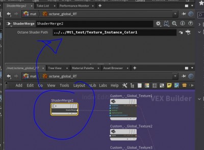

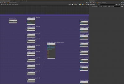

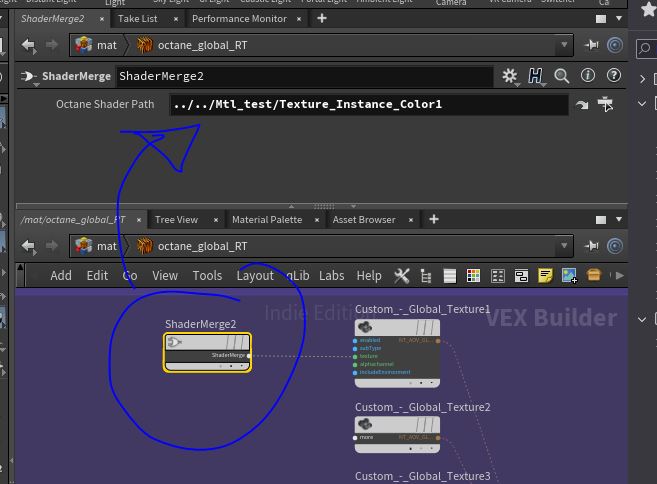

You already did it. You were just using the wrong Render Target. You were using /mat/octane_mat_renderTarget1 but you set up the global texture aov for /mat/Mtl_test/octane_render_target1.
If you want to use the Render Target HDA, one of the ways to ways to do it with that is to unlock it and dive inside it. Add Shader Merge node and get Texture_Instance_Color1 thats inside the Mtl_test, and connect that to the Global_Texture input, like this: I've attached the file with 2 ROPs. One is using the Octane Render Target HDA(and the method mentioned above) and one is using render target that you created inside the material Mtl_test.

and you did add some magic in the scene, the tricks is to :
- unlock the render target
- add a shader merge and plug it
- link the texture instance color to the shader merge
- you create the render target inside the shader to specify the export
- you pick the global render target
and it works
