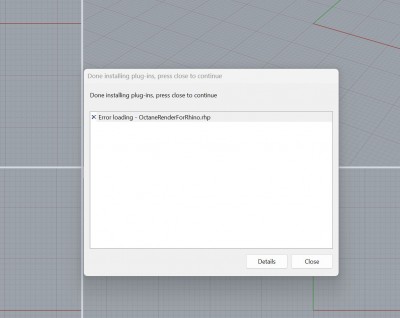

installed the latest version:
the plugin´s path looks weird though:

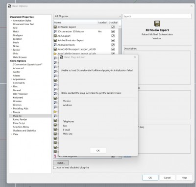

I have not yet installed Rhino 8. From what I have read, it is month (years?) away from being released. I will install next week to take a look. You are right - the install path looks quirky.v-cube wrote:Is it working for you ?

I have escalated this to McNell. Please see https://discourse.mcneel.com/t/plugin-n ... wip/157719 for details.
Paul
Paul
McNeel have answered my question, and I think I can resolve it, although it will take some work (as I need to swap out some of the libraries that the current release of the plugin uses). I will try to get this done for the Octane 2022.1.1 version of the plugin (available in a week or so).
