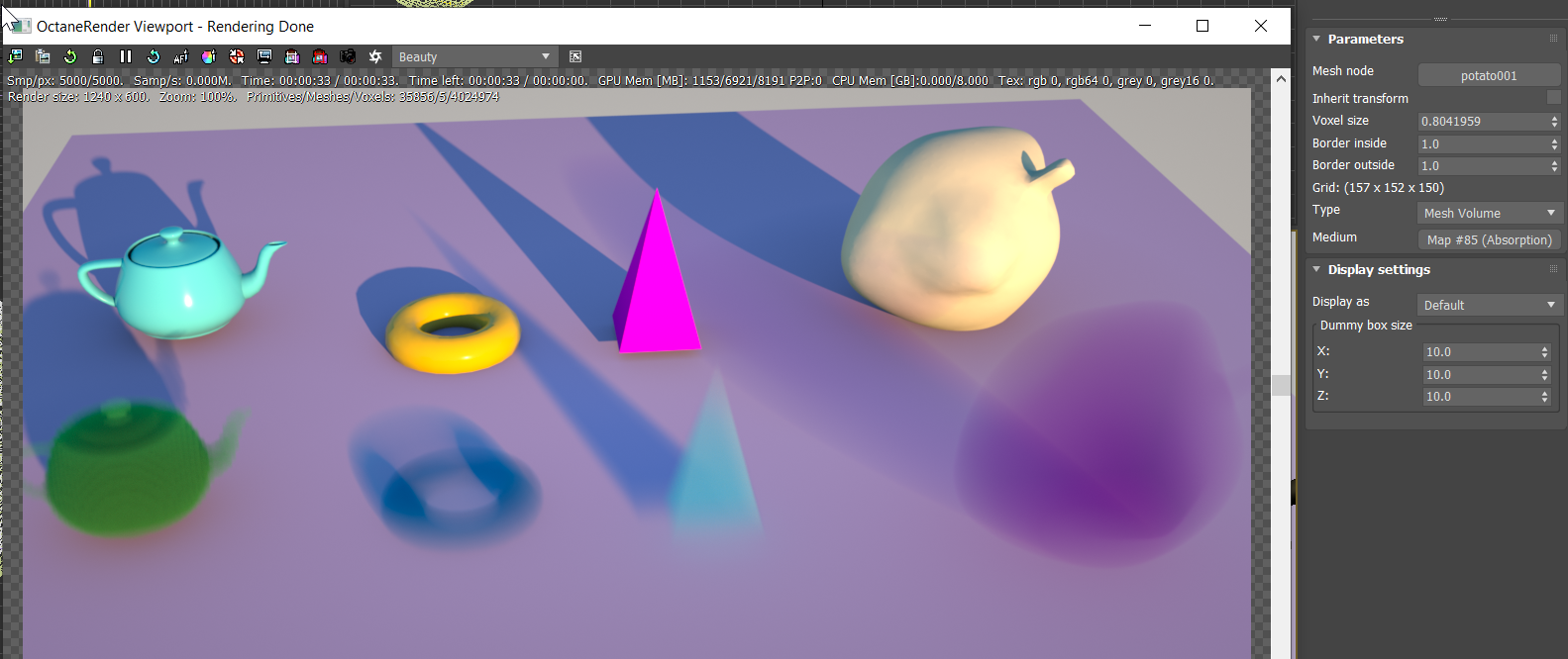

Octane Volume:
With the Type set to Octane Volume, you can apply a Medium texmap.
Here are some examples:

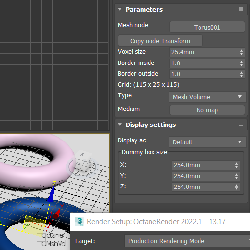

Hi HHbomb,
I checked the download link for OctaneRender_Studio+_for_3ds_Max_2022.1_-_13.17.exe; it's the correct version.
I tested with max2023, max2020 and max2018, here is the UI I see:
(Note that 3dsmax version 2013 to 2017 are not included in this release)
Try to create a default Torus,
Then a MeshVolume.
Before clicking on the 'Mesh node' button, see the description line at the bottom of 3dsmax window, that should be the usual 'Click and drag to select and move object'
When you click on 'Mesh node', it should change to 'Pick a geometry node..'
You should be able to click on the Torus, and the torus button name will change to Torus001, and the torus shape will be displayed for the MeshVolume object in the 3dsMax viewport..
(I forgot to mention that the MeshVolume object should be set as 'Movable proxy' in the Octane properties. that will be fixed in the next release..)
Witch version of 3dsMax are you using ?
Could you post a screenshot of the UI you see?
