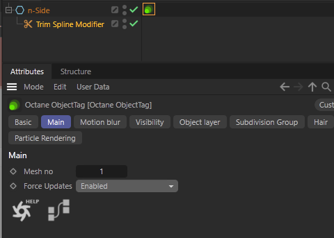

I had a go, just learned of the tool yesterday, great addition.
If you make 'force Updates' TRUE in tag, it worked correctly for me
