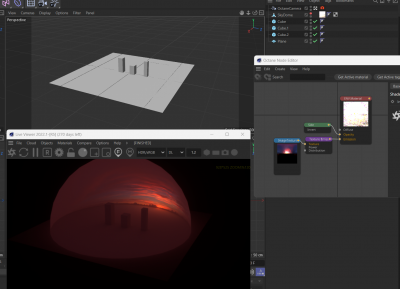

Yup, or a hemisphere, depending on your needs. Just make sure the surface normals are flipped so it renders on the inside and put the HDRI in the Emission channel. I don't have any specific numbers, as far as size goes, but make it big enough that no geometry is too close to the emitting surface to avoid hot spots. Also, the more camera movement distance you have, the farther away the dome needs to be to avoid obvious motion parallax, blowing the illusion. One option to avoid this without scaling up, scene allowing, is to drive the dome's X Z position with the render camera's so that it remains at a constant distance.
If you plug a "Side" node into the opacity of the dome material, you can set it so that only the inside of the dome is visible in the Live Viewer. This way you don't have to worry about the dome itself blocking your view.
Sky Dome visibility tweaks.
