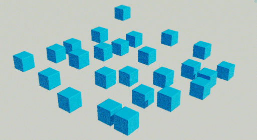

Material assignment on packed primitives is messed up in this version.
If you apply a material to a packed primitive that is imported as "native instance" or "create point instancer" it assigns the material and rounded edges even work but all the other material parameters are ignored. Only if you import as "Create Xforms" (which basically disabled instancing) the material assignment works correctly. When testing with Karma this works fine, so it's definitely just an octane error. This also was not an error previously.

HandcraftedMedia
Posts: 73
Joined: Thu Jan 10, 2019 12:15 am
When rendering with packed primitive set to "Create Xforms" some of the elements pop in and out of place. If you set it to "Create Point Instancer" that doesn't happen, but also the materials don't work.

HandcraftedMedia
Posts: 73
Went back and checked and none of these issues exist for 19.5.403 combined with the 19.5.435 octane build.

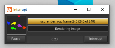

HandcraftedMedia
Posts: 73
Also tested it with 19.5.493 with the 19.5.435 octane build and also none of those issues show up.
The only thing that's buggy with the houdini builds after 19.5.403 (that's for the .435 octane build and the new one too) is that this window stays open after completion/gets stuck on the last element, vs before it would close and you could see the renders in the render scheduler window. Not a massive problem, but a little bit of an inconvenience, as you can't see your render times and it locks up the houdini window.
