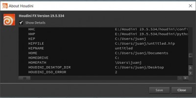

Hmm, the plugin saves the pref file to the standard $HOME directory as it is defined in the environment variable (it is an HDK function, so I'm not sure about the internals). What do you have in your $HOME variable? This is mine from the Houdini "About" window.
Thanks,
-Juanjo
