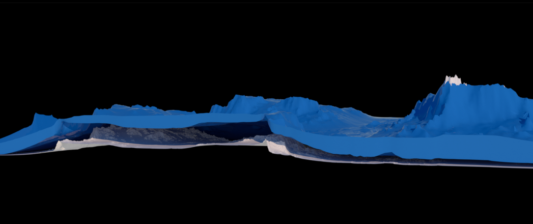

silanbekjarov
Posts: 35
Joined: Tue Apr 13, 2021 12:52 pm
Forgot the screeny
jayroth2020
Posts: 492
Joined: Mon May 04, 2020 7:30 pm
Actually, Octane was just updated earlier this week, so go ahead and grab the latest if you can. It may not matter, but best to be sure.
