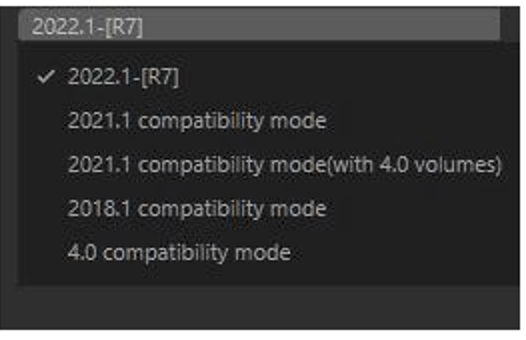

With the Octane License changing to Studio+ there comes an issue with being able to use versions previous to 2022. We use Modo and C4D.
In C4D there is a kernel compatibility over ride that allows the user to set the kernel to behave as the previous versions.
We are stuck on 2020.1.5, 2021.1.5 for some particular master sets used in our modo workflow. Can you implement this in the Modo plugin?

Hi Rick - I have looked into this, but implementing it in the Modo plugin is quite difficult, sorry. Perhaps OTOY can assist by providing an Enterprise license for that you can continue with the 2021.1 version of the plugin?
