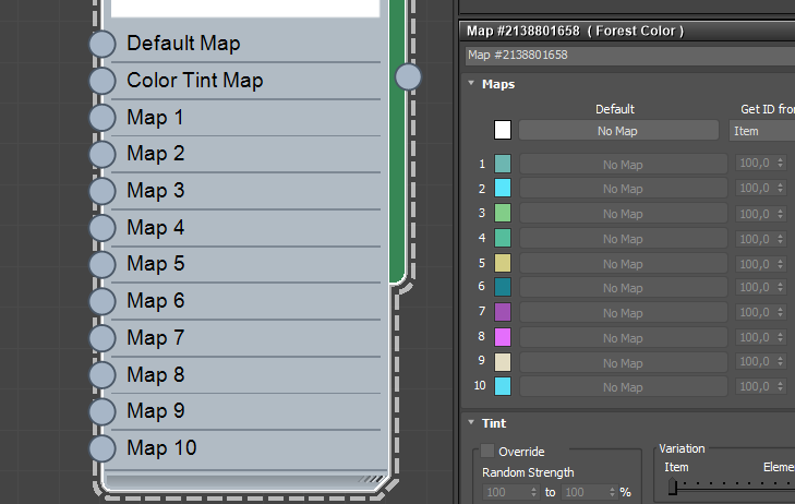

-For the Forest Color and it's 10 maps, that's from Itoo Software.. I didn't do the UI, I'm just reading and converting the data to render something similar with Octane..

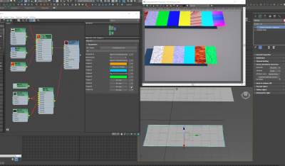

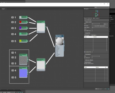

Hey,
- I was trying to use ForestColor as a replacement for Multi-Texture. But the ForetColor is Object based, i could not use in a single object with multiples IDS.
- Why didn't you make Multi-Texture with the possibility to link textures to slots?
Or at least slots where you can load textures. (like the ForestColor UI and all the other Multi-Texture ones from Corona, Vray, Fstrom etc... )
- As in the image, I at least could not use it because the textures have to be loaded sequentially, or several times... very counterproductive.

By updating the internal osl shader used for Forest Color, I could make a shader that should fit your purpose:
TextureSelector10.zip
(444.16 KiB) Downloaded 120 times
Plane01 has 6 material IDs from 1 to 6, and 2 'TexSelector10' osl textures, one for the diffuse, 1 for the bump
Plane003 has 10 materials IDs from 1 to 10, and a single TexSelector10 for the diffuse.
(Plane02, as a reference, uses the Material Selector)
Would this work for you ?
Is 10 slots enough ?
I could create a Wrapper for it, to avoid to set up the osl shader name and grayScale vertex attribute, and add a Reference Objects window as in the Multi-texture, to make sure objects have the Octane Geometry Modifier correctly setup.
