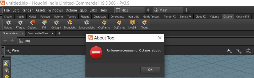

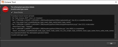

error on clicking a octane button (image attached)
Traceback (most recent call last):
File "Add_Octane_ROP", line 1, in <module>
File "C:\PROGRA~1/SIDEEF~1/HOUDIN~1.368/houdini/python3.9libs\roptoolutils.py", line 10, in createRenderNode
rop = hou.node('/out').createNode(rop_type, exact_type_name=exact_type_name)
File "C:\PROGRA~1/SIDEEF~1/HOUDIN~1.368/houdini/python3.9libs\houpythonportion\ui.py", line 1112, in decorator
return func(*args, **kwargs)
File "C:\PROGRA~1/SIDEEF~1/HOUDIN~1.368/houdini/python3.9libs\hou.py", line 14553, in createNode
return _hou.Node_createNode(self, node_type_name, node_name, run_init_scripts, load_contents, exact_type_name, force_valid_node_name)
hou.OperationFailed: The attempted operation failed.
Invalid node type name

this happens when i click any octane button
error code
error code

That means that Houdini can find the plugin but can't load it. Does Octane Standalone 2021.1.6 work fine on this system?
Perhaps you could try to configure the plugin using absolute paths, without this $HOU variable to check if it helps.

Hi Juan
That did the trick!
Thanks :)
