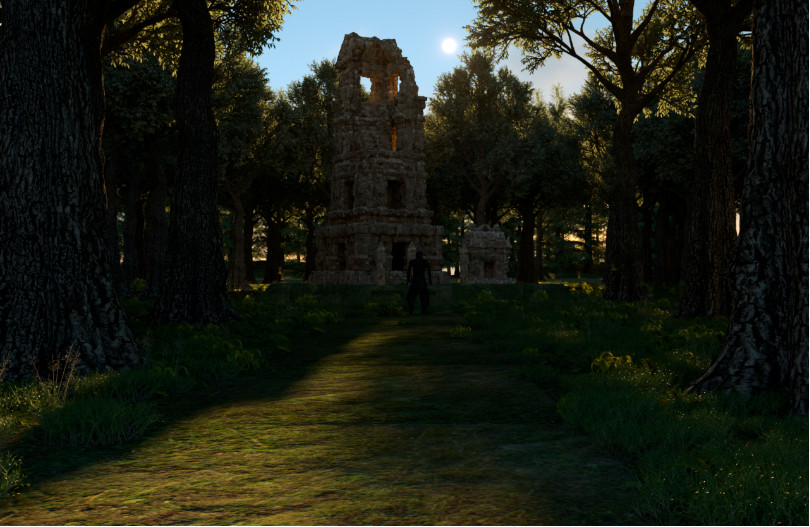

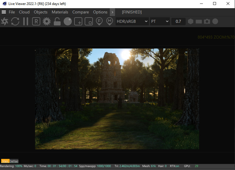

Hi all. As you can see in the pics below I have an issue with a rendering. I've activated the Post Processing settings (bloom effect) and in the Live Viewer it works, but in the final render (C4D system, not AOVs) it doesn't work. What am I doing wrong? Thanks

What's render resolutions? Post effects are pixel size based. Not rational to dimensions as you can notify

Thanks for the reply, the render settings are 1280x800, 72 DPI.

Please enable the Lock icon in Live View, to have the same resolution as Picture Viewer.
Please also check to have enabled the Use denoised beauty pass option in Render Settings/OctaneRender/Main tab, thanks.

Ciao Beppe, "Use denoised beauty pass" is checked but now there is another issue. If I lock the Live Viewer I have a crash. If I uncheck it the render starts but with same previous issue. Here's the log report
